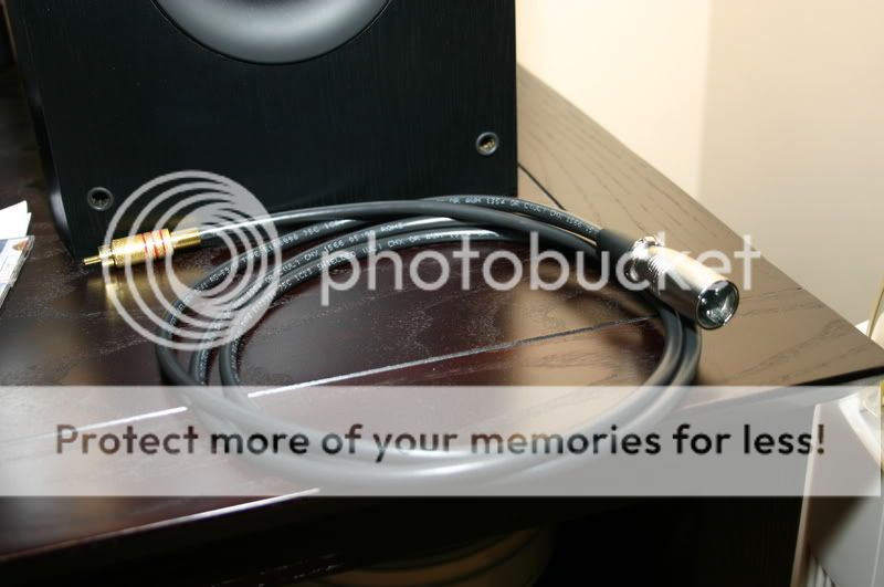

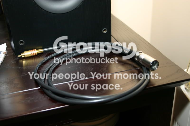

try the adapter i attached a picture of, the 1/4" TRS ... it got rid of the slight hum i had.
