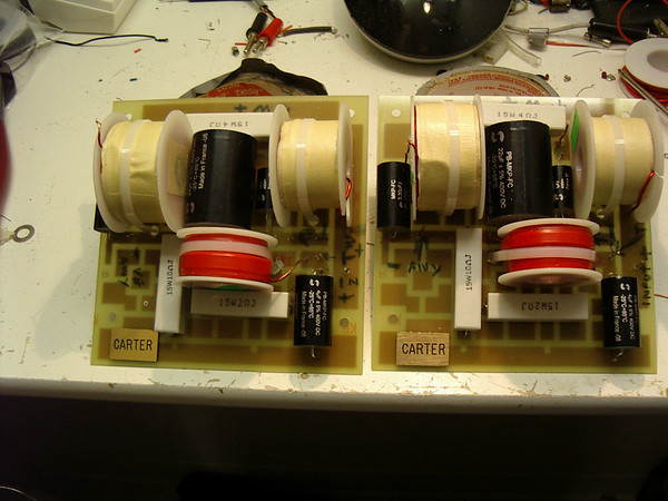

this is one of the xovers, is it well built or not?

well this is the second layout, but what do i do? do i leave them the way they are, or do i have to modify one of them or both or what do i do?
I'm sorry, but those crossover are badly built. The inductors are all on the same axis, and some are touching. There will be huge mutual inductance issues. I'm sorry but those crossovers have to be rebuilt.
The inductors should be separated as far as possible and their axes varied. I explained all this in a post earlier.
There is a reason these inductors are on opposite sides of the board, and the high pass filter's inductor is at right angles to the low pass filter's inductors.
I obviously can not tell of the components are properly connected.
If getting these crossovers right is a big problem for you, you can ship them to me and I can build them correctly.
