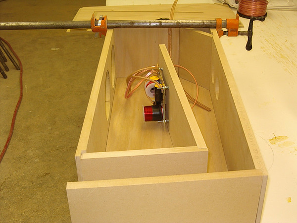

so do i have to drill trough the back of the cabinet? or is there any other option to put it? Dr. wouldn't you have a picture of a xover inside of a cabinet so i can see how do i have to do it?
I would mount it on the back behind the woofers, or on the bottom.
I think this is the type of picture you are asking for.

great picture and also great cabinet, thanks that was the kind of picture i was waiting for, but, that's a different kind of cabinet, in the kind of cab i'm working on, what if i mount the xover on a piece of wood and then paste the wood inside the cab, then i do same as you told me to do, but woulnd'ti be messing up with the internal volume of the cabinet afecting the internal volume?
