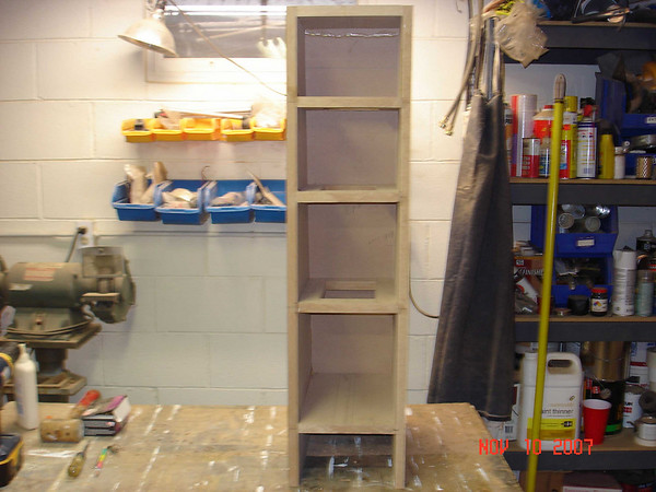

I worked up the plan for the main cabinets tonight. I don't have any fancy computerized pictures yet, but I will post what I came up with.
I have the interior cabinet 38" tall and 7" X 7" with bracing alternating every 6" or 7"" all the way down. I designed it around the top of the tweeter at 40". This gives me about 9" of space at the bottom that is not part of the sound chamber. I was thinking that I should put some ballast in these as they have a fairly narrow foot print and will be slightly top heavy and sitting on carpet.
Please let me know what you think.
Jason
That wasn't quite clear.
The total tower will be about 48" tall to give me the height I want at the tweeter, the sound chamber is about 38" so that leaves me the 9" of dead space below the bottom of the chamber. I thought that a finished box of about 9" X 9" and 48" tall with more weight at the top wouldn't be the best choice without ballast.
Sorry to ignore you today. we had a Minnesota blizzard yesterday, about 5.5 inches of snow with a really good wind behind it. I was on my 1848 Model a John Deere, clearing our 1/2 mile road in, my lot and a couple of neighbors.
That cabinet seems a little tall to me. I think it would look better if it were a few inches shorter. You should be able to shorten it 6 inches I would have thought.
It will be fine to put sand in the base though. Make sure it is clean and dry. If it is contaminated with organic material and or wet you will have a big problem.

This height is essentialy as short as I can make it putting the tweeter at 36". With her sitting on the couch her ear is right about 36", mine is closer to 39".
Do you think it would be better to loose about 5" - 6" of the dead space on the bottom and shorten it up?
I have a simple CAD drawing made up, but I am can't get it to show up well here. When I copied it to make it a jpeg it highlights everything and adds in all the adjustment points and make unreadable.

Anyway, on the mains, Do you think I ought to shorten the cabinet some? It has been said that the optimum height is tweeter at ear level. Is there a range that you won't notice the difference? Am I being too literal?
I nearly missed your last paragraph.
I think if you limit cabinet height to 42 to 44" it will make no difference acoustically, but will look much better. A narrow cabinet 48" tall does not look very good.
