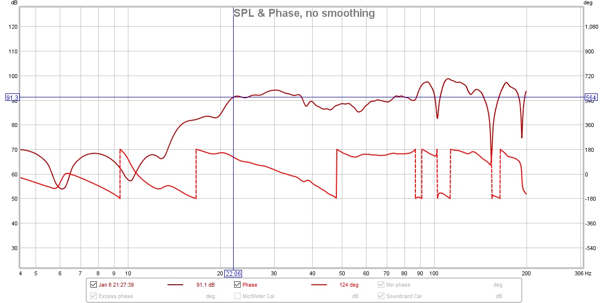

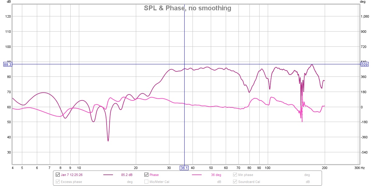

To clarify:
This is a small bedroom setup. The room is 12x11x8, the system is oriented along the length dimension, the seats are about a foot off the back wall.
There is a closet that is semi open with sliding doors at the front left side of the room. This is a no go placement area because for whatever reason the closet causes a loss of anything below 40hz.
The two practical options for the sub is either the front right corner, which results in a 10dB peak at 50hz, or the rear right corner, which results in a 6dB peak at 50hz. I chose the front right corner because it offers a completely even response throughout the back of the room can the rear corner. It may be peaky, but it is consistently peaky everywhere lol.
The thinking behind bass trap treatments has to do with the fact it seems Audyssey has a harder time correcting the response in this room vs my larger living room, which is significantly less problematic. Here is the latest calibration results
I don’t think eq is incapable of fixing the issue, just that Audyssey is having a harder time sorting out what is a room problem that can be corrected and what isn’t because the peaks are so extreme.
Using manual parametric EQ via equalizer apo on my pc, on my front l/r speakers (no sub), I managed to achieve almost perfectly flat bass as you can see here
I will have to upload an uncorrected graph tomorrow morning, but it really boils down to nothing more than a giant 10dB peak centered at 50hz that’s about 12dB/octave wide.
So far, I have come up with a few possible solutions, I guess what I’m asking is which would be most effective while still being practical from a cost and space standpoint.
Option one:
Using a minidsp on the subwoofer to flatten the worst peaks, leaving Audyssey with less work to do and theoretically achieving better results post calibration.
Option two would be minidsps on all 7 speaker and the sub, however, that can get very costly with all the necessary external amplification.
Option three I’ve considered is similar to what @gene mentioned, multiple subs to give a perfectly even response, with a high (120hz) xover and minidsps on the subs only. The issue I am running into with this is finding a sub that is both small enough to use in multiple locations considering the limited space, while also achieving an f3 of at least 25hz.
The subwoofer currently in use is a Dayton sub 1500, which, as you can see from the above measurements, extends to 22hz -3dB and still has useful output @19Hz -6dB. The only 10” sub I’ve found so far that can achieve a decent response below 30hz is the svs pb 1000, which is too large due to the cabinet size. Most smaller subs roll of below 30hz, which seems pointless imo considering my front speakers can achieve decent output at 30hz in room with minimal distortion without the help of a sub.
If I went the multiple sub route, considering the room size, would something like 2-3 Dayton 10” ultimax subs eq’ed via a linkwitz transform to 20hz give enough output, or would it be pushing the drivers too hard? As I previously said, I will upload some more graphs and a diagram later, but with room gain I get 10dB @50hz, 5dB @25hz, and 3dB @20Hz.

Thank you for the details!
Now, first things first, FLAT IS NOT THE GOAL! I think there's a lot of readers that would like to get a 5 dB gain at 25 hz (particularly the owners of PSA subs - I keed, I keed! Lol!) It's really a silly concept when you consider the size of wavelengths being picked up by an Omni-Directional mic, how can any two rooms measure the same? (this was also covered in Floyd Toole's "Measurement and Calibration of Sound Reproducing Systems" - a free AES article, as a further explanation of why current 'Room Correction' solutions are fundamentally flawed)
I'm really trying to drive that point home as a rhetorical question to anyone (cuz I keep having to reinforce it)- if resonances are the building blocks of all sound, why are you arbitrarily cancelling out 'peaks' that are not centered on a modal frequency?
But what you may not realize, is you're giving yourself the data you need by recording measurements with different sub positions. If positioning a pressure source at either end of the 11' wall is causing a 5-10 dB gain at a predicted frequency, congratulations, you have just influenced a room mode! Now to drive that standing wave away from your LP.
The boundaries of your room, or really anyones room are smaller in dimension than most of the bass wavelengths being reproduced. And as I've seen you post, you understand that even 1/4 wavelengths can be an issue - you just don't always seem to apply that math correctly to absorption and give thin foam waaaay too much credit.
If you search Harman White Papers you will find subwoofer integration articles from Todd Welti, who created the MSV - Mean Spatial Variance metric which defines a value for the SPL level differences, seat to seat. His research in to integrating subs in to small rooms went from 1 subwoofer, to infinity. The simple take away is the more subwoofers (regardless of size) the more even the bass distribution will be throughout the room.
So if you can provide a detailed layout of the room, speaker complement, LFE crossover, and measurements withOUT DSP or Audyssey we might be able to help you situate your equipment to save you from needing to shoehorn additional subs into a small space.

I definitely agree some amount of room gain sounds natural, but 10dB at a single frequency does not lol. Harman has a shelved response from 60hz and below built into their target curve. This could easily be recreated by simply crossing my speakers at 60hz and bumping the sub up higher.
I don't know what this target curve is, nor did you quote me correctly, but it sounds like you're blurring the lines between a room curve and anechoic speaker measurements. Despite that, it seems we've already found your first solution, change your LFE crossover:
If you have a resonance at 50 hz, but the sub is rolled off at 40 hz, you have no way to influence that mode!
Based on your dimensions, an 80 hz LFE crossover puts your subwoofers in control of the length, width, height modes of your room.
So it's good you posted this first before measuring! I would start with an 80 hz crossover, with no DSP or Audyssey influence.
Crossing the L/Rspeakers at 40Hz, Center at 60Hz and surrounds at 60Hz and expecting the crossovers to have a brick wall effect will get you...... peaks where you don't want them. You need to look at this as it would be taught in a Physics class when they work with wave theory- the sound energy from each speaker will interact with the sound energy from all of the others. You can't stop that unless you only allow each to play when the others aren't, or put them in separate rooms. At any other time, the interaction will result in interference- both constructive and destructive. The thing that makes it different from the Physics class water tank is that we're working in three dimensions.
If you set the sub to 60Hz and the rest of the speakers to work above 80Hz, you won't lose anything because the crossover slope will still allow all speakers to produce sound between those frequencies. In fact, even with 18dB/octave slope on the sub and 12dB/octave on the rest, you may need to work with the range where the crossovers overlap in order to reduce the hump (or raise the surrounding frequencies and drop the overall level). If the sub is currently crossed over at 60Hz, it would explain the hump in your response. Sometimes, it's necessary to create a gap in the response in order to smooth the overall response.
Run the RTA with no crossover and only the main speakers, then the center, then only the sub, then only the surround speakers. Once you have measured for these, run the mains and add the center and look at the changes. Continue by adding the surrounds and note any changes. Hold off adding the sub- if you still see a rise in the 40Hz-60Hz region, it's an issue of room modes and mic placement. If it's smooth and you see no problems, add the sub- what happens? If the crossover is set below the range of the other speakers, introduce them to your li'l fren', errr, the HP crossover. Raise it to 60Hz, then 80Hz and watch the response. Work with the sub's crossover until you see what you want, then listen to some music and adjust accordingly.
When I had an AVR, I found that setting the increments for distance to .1 foot made it possible to tweak the sound much better- the difference between ex. 12.3' and 12.4' was slightly audible, but having .2' difference could definitely be heard. It could be seen on the RTA, too.
Remember- as posted before, flat ISN'T what you want- you want a "house curve", which is smooth, with a definite downward tilt from low frequencies to high frequencies. Flat doesn't sound good- it just allows designers to create a known response in certain conditions.
Don't worry if you think the sound of the system is better with deviations from flat and/or smooth- find a curve you like and go with it.

@everettT
The mic may not be perfectly calibrated but the bass response measured in REW is pretty much identical to the uncorrected response displayed in the Audyssey app, so its good enough.
