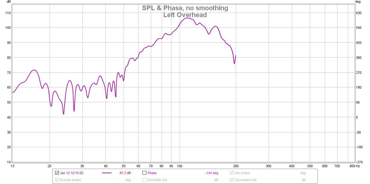

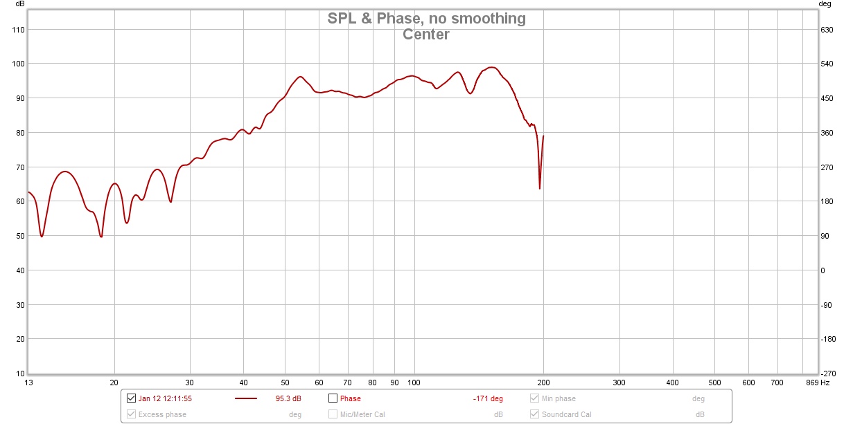

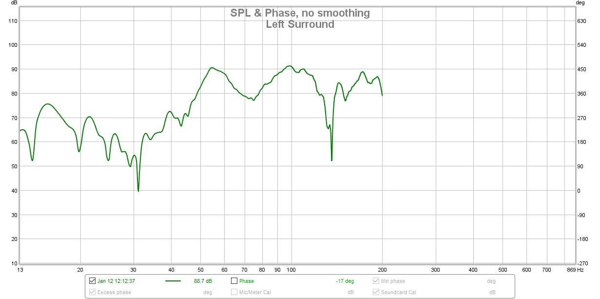

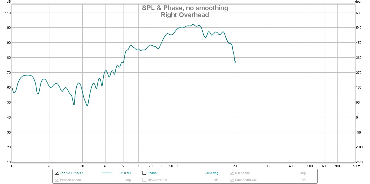

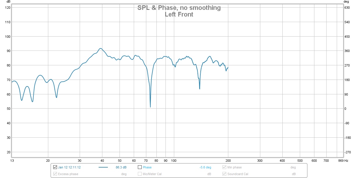

I included the left speaker by itself to illustrate the steep drop off below 40hz on the front left side of the room near the closet. I get the same problem if I place a sub there.

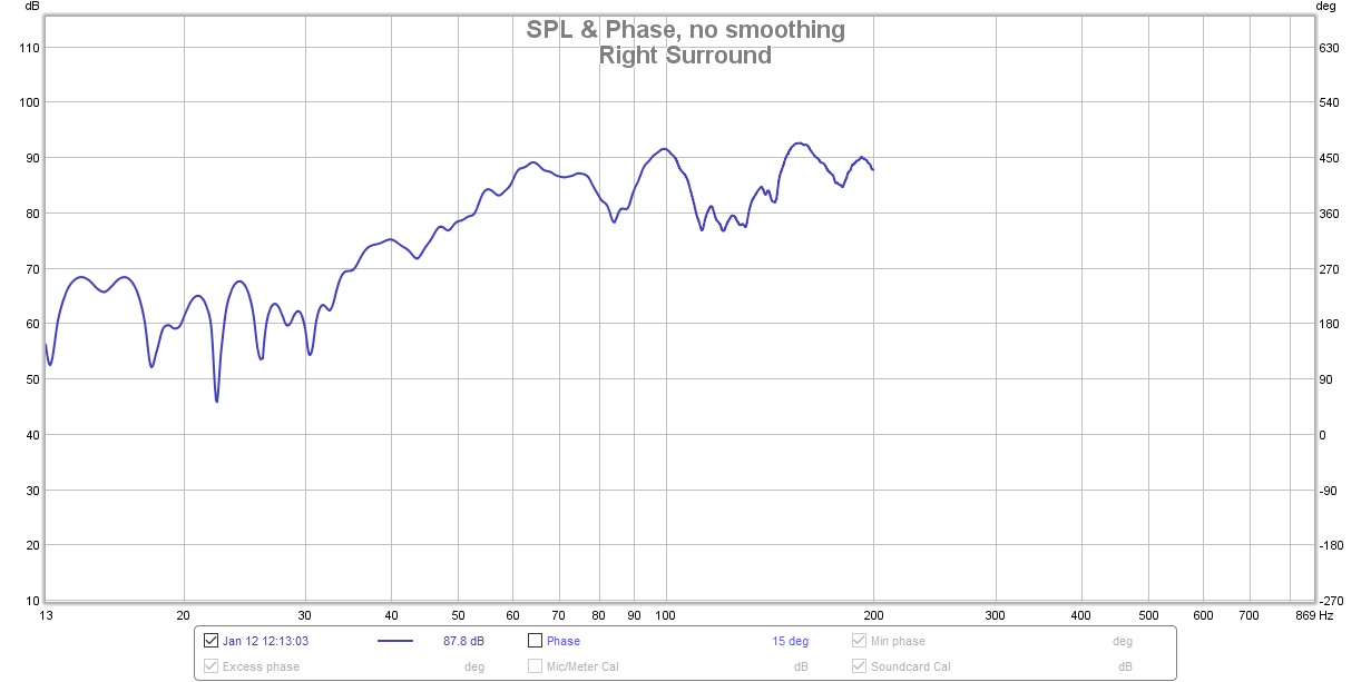

I’m assuming the reason the surrounds and center don’t suffer as much of a peak is because they would normally roll off anechoic at about 63hz.
Y
yepimonfire

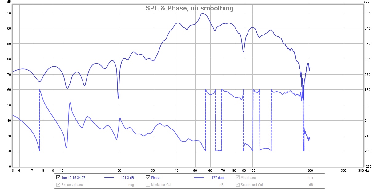

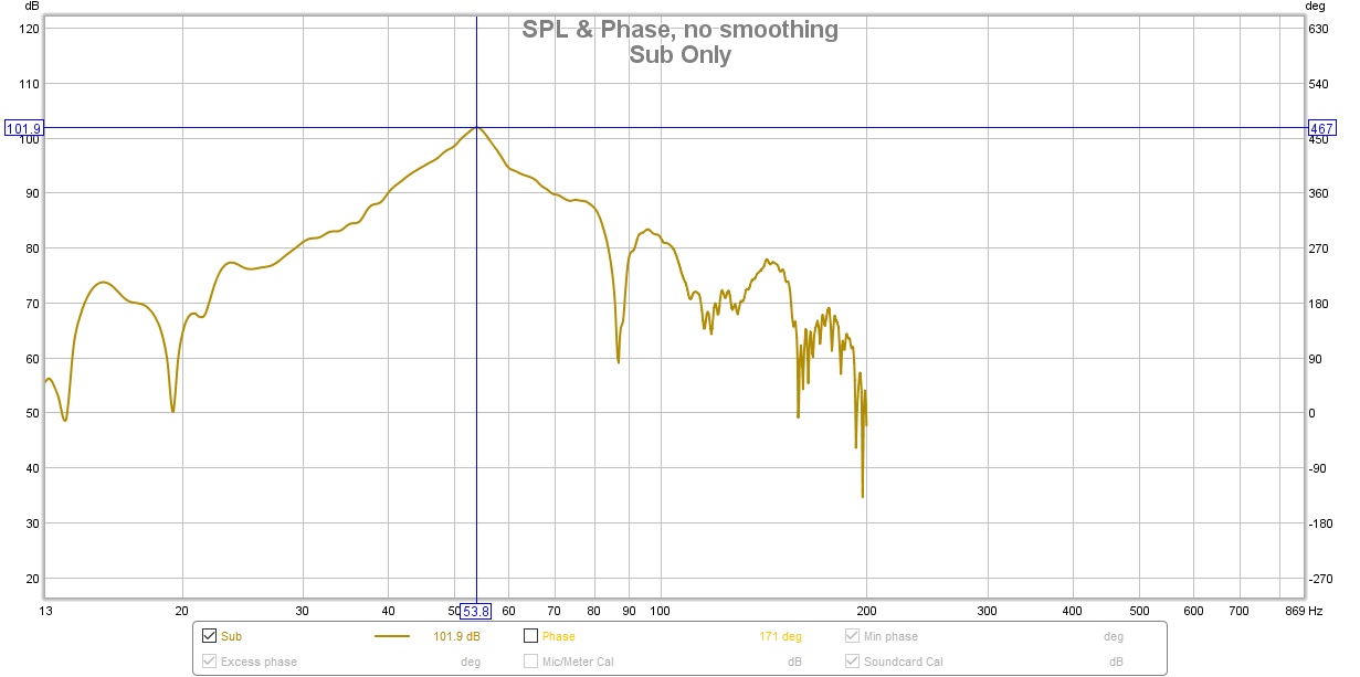

Okay, I pulled the sub out and sat it in the mlp and measured around the room. Turns out, I found a relatively flat spot, but there’s a massive loss of content below 40hz. This seemed to be the case no matter where in the room I took measurements, leading me to believe it has to do with the listening position, not the sub placement. Lugging a big sub to different areas wasn’t practical, so I guess at this point I will just have to put the sub there and hope I can find a better measuring seating area.
Any idea what could be causing the loss below 40hz? This is sitting center left of the midpoint of the back wall. The phase response doesn’t suggest a room null spot, and neither does the group delay.
It almost looks similar to the bass leakage effect one sees sitting/placing a sub or speaker near an opening to another room. The dip is down almost 48 dB/octave

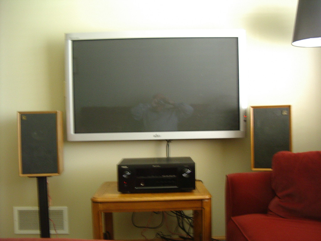

I came down to Eagan today. My wife is watching a movie on the main rig here.
I'm in a small room, that was a small bedroom but that we converted to a game room for the grandchildren.
I have just listened to the first half of the Friday evening concert of the Minnesota Orchestra live on this rig.
I'm just using two full range drivers with 4" aluminum cones weight 6 GM each. These drivers reach into the 40 Hz range.
The concert is very enjoyable and in this small room with plenty of bass gain the sound is full bodied and in no way anemic. We are talking a speaker design here nearly 60 years old. The sound is beautifully balanced.
I have thought of adding a couple of subs. However, I'm pretty sure I would create problems I don't now have. I never feel I need more bass listening to these speakers in this small room.
I listen to "Pipe Dreams" on occasions in this space, and I'm always astonished by the authority and clarity this rig brings to pipe organs even.

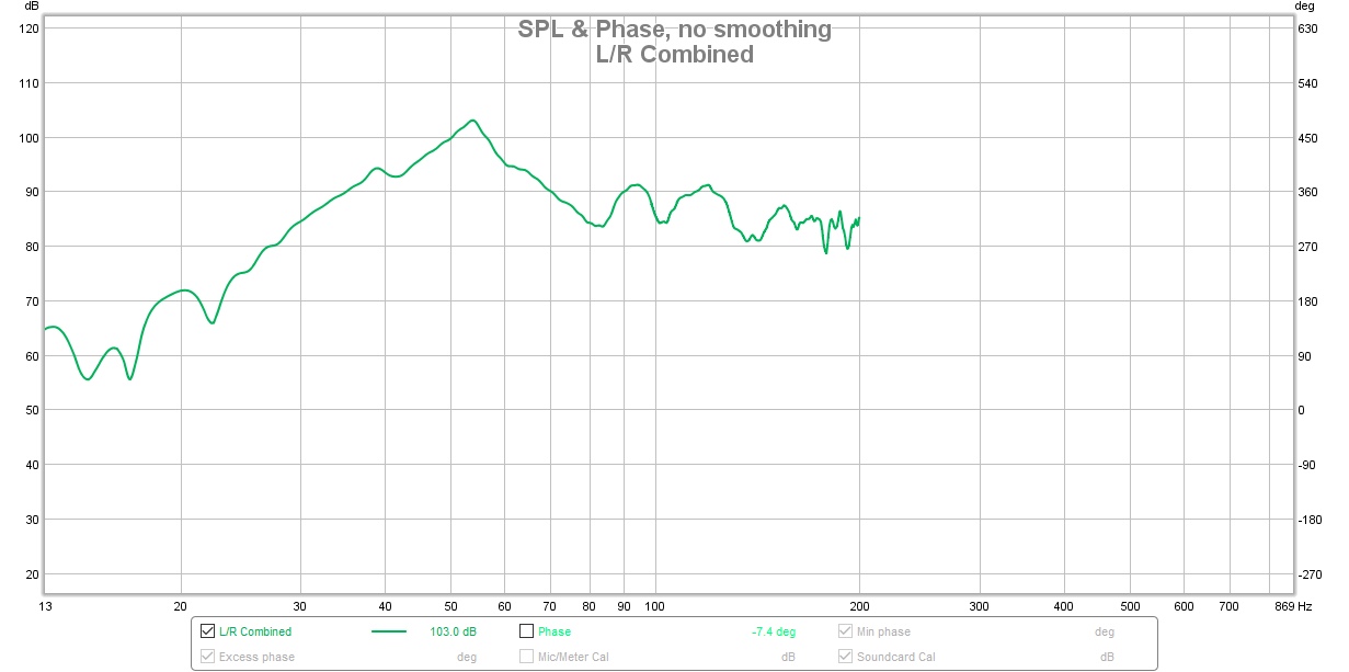

I think you do have a point. With Audyssey enabled, if i measure the sub by itself, it starts rolling off at 30hz and is down almost 7dB at 23hz, if I measure the mains crossed to the sub @40hz, the combined response is pretty much flat to 22hz.
Considering the rp-160m is easily able to reproduce full range content down to 32hz without distortion in my room, I’m wondering if it might be beneficial to set them full range and utilize the lfe+main setting in the avr with a 60-80hz xover. As of right now, the combined response with an 80hz xover vs 40hz is worse.

I have never built a mass loaded TL.
Shorter line of mains.
Long line being built round the short line.
Note the large ports at the open end of the long pipe.
The center channel line
There are no lines opening into resonant ported cavities.
Whoops, brain error.... I've only studied pipes, completely forgot the coupling chamber just exits into fluff.
