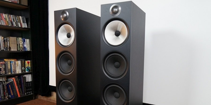

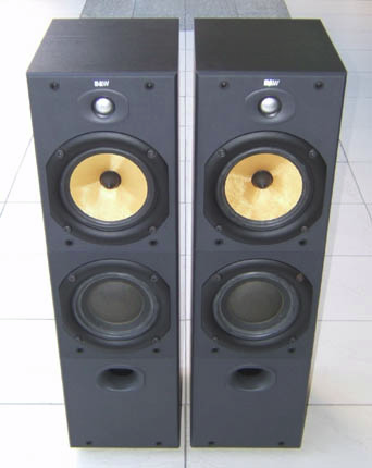

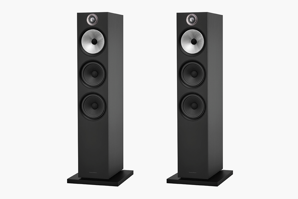

Over the years, B&W has used some confusing names for it's speakers. Do your 603 s2 speakers look like this?
Or this?
If they have those yellow Kevlar mid-range drivers, they are the cause of your ear distress. I thought B&W's new gray-colored replacement was intended to eliminate that problem. But James Larson's review and measurements indicate there still may be a problem with them.
See the broad peak around 3 kHz in the green trace below. That is caused by the mid-range driver going into break-up. To avoid that noise, B&W should make the mid-to-tweeter crossover frequency lower. But they didn't.
