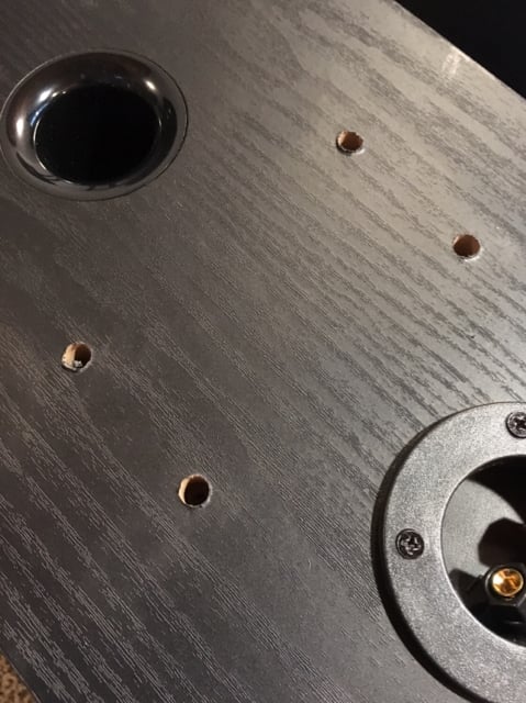

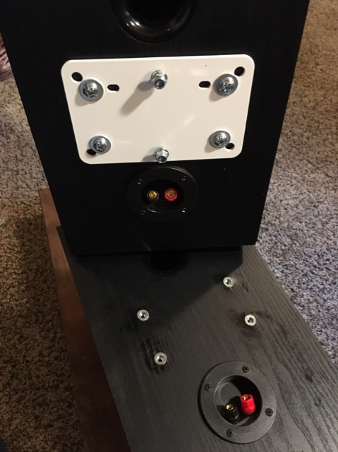

A few more steps along the path:
Not gonna lie: this hurt my soul a little bit.
At least I didn’t miss the spot!
Voilà!
ryanosaur
ryanosaur
*sigh...
I had to find an inexpensive solution for the horrible way I have the Mini-Phils set up... found a VideoSecu stand that was $40. And you know what you get for a $40 Stand (pair)... Two $5 dollar stands, packaging, branding, import fees...
I'll play with them tomorrow, see if I can rig up a stable base to keep them from tipping over when I put the Mini-Phils on them.
Cheers, all!

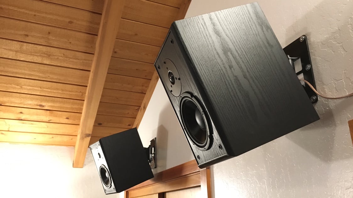

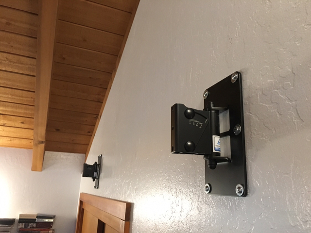

Voilà!
Ah, the things we do for love...
