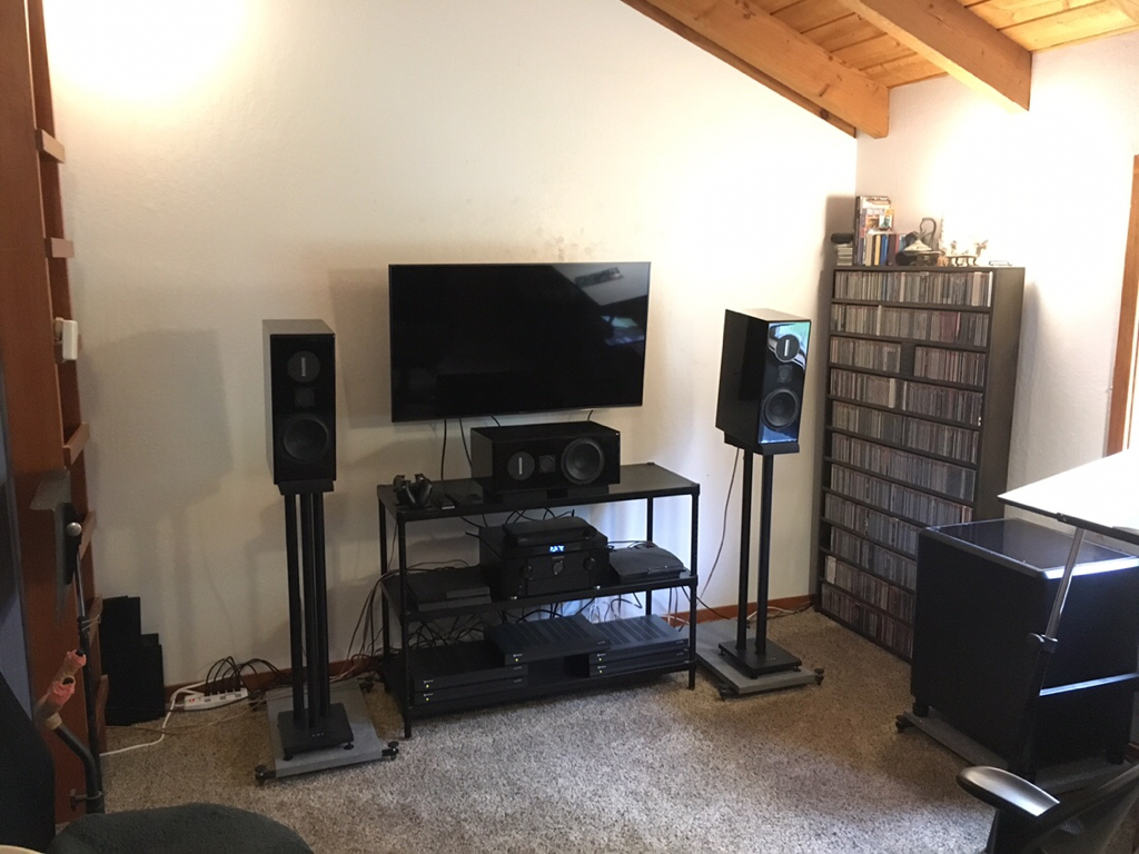

Wheeee! Finally have the room dialed in a bit more... few things left to do: address my equipment rack and cable management. And OMFG do I need to get my CM on.
Anybody got some good Polpette al Sugo? I got the Pasghetti! ;)
As promised. More gear porn!
The front:
BMR:
X-13

I would try to get a little more space between the main speakers unless they sound best as is. Worth a shot. :)

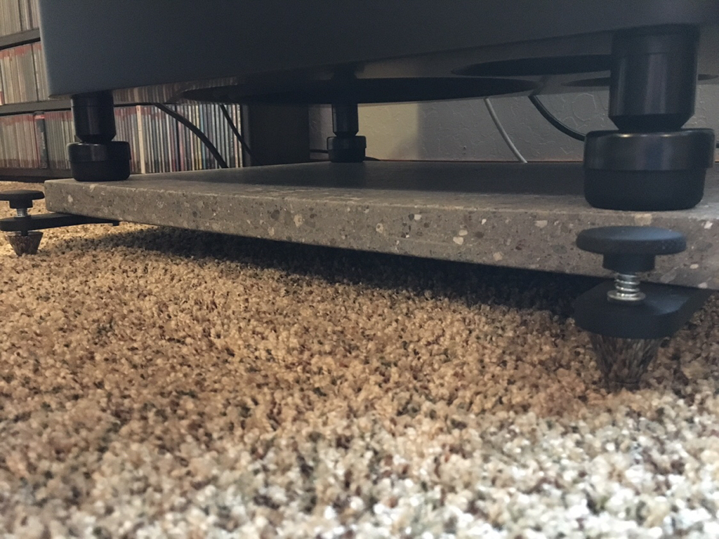

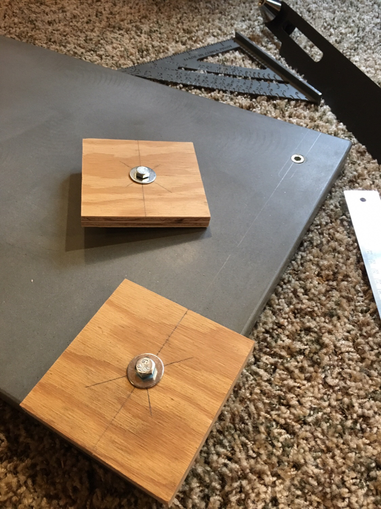

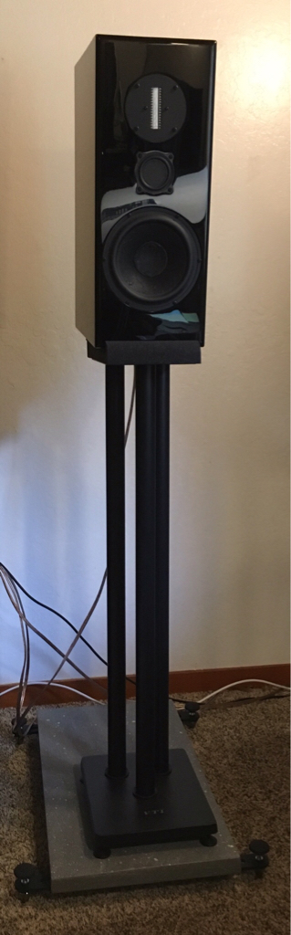

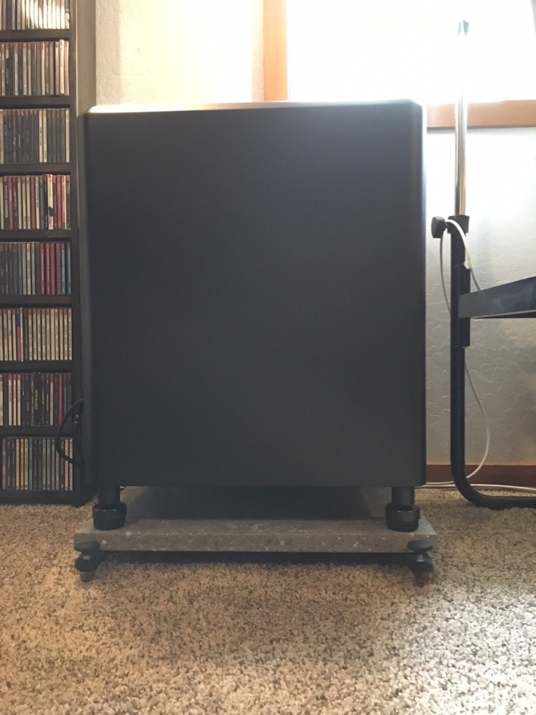

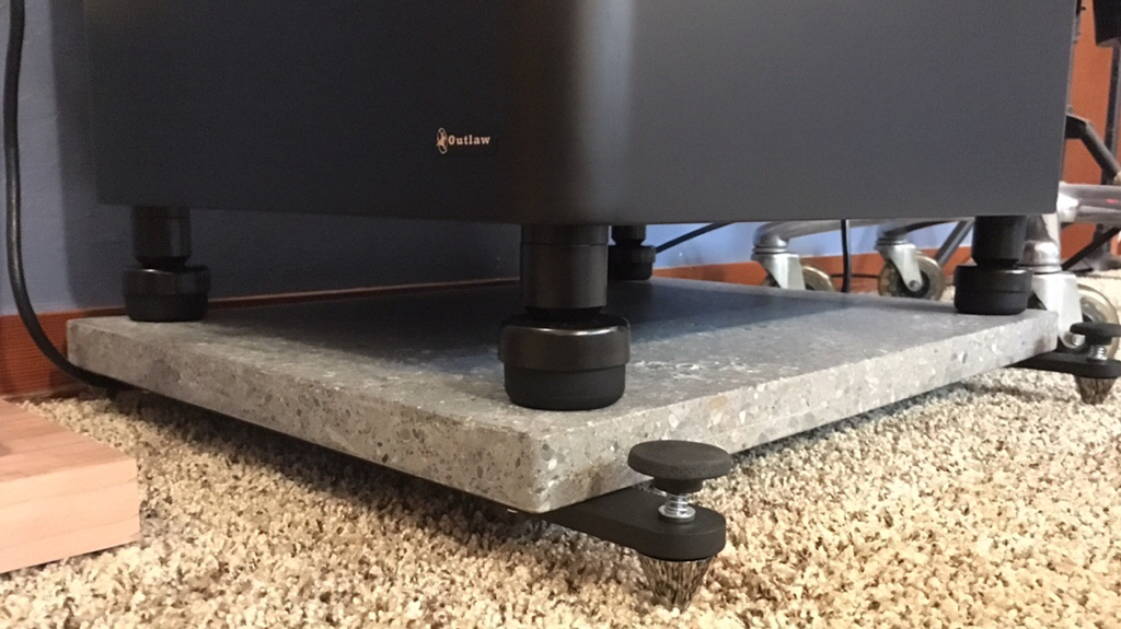

So the pads are concrete remnants from a local company... acoustics are pretty neutral... much like granite, doesn’t ring when you knock... They touched them up for me and drilled the holes so I could attach the outriggers. Threaded inserts set with epoxy.
For the subs, I chose to try the SVS isolation feet. They work! Either, by themselves was good, but together (feet+pads), I have cut household vibrations by 85-90% I would guess. And the bass is much tighter.

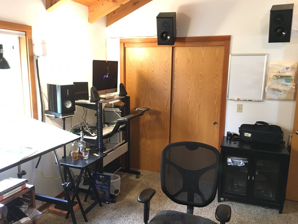

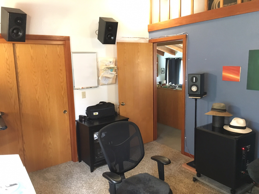

And for the rest:

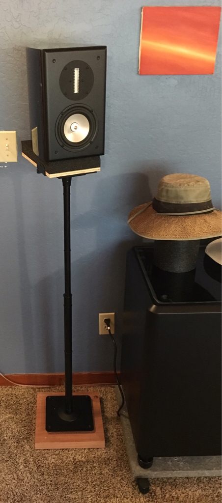

R-Surround: Mini-Phil and Rears: Dayton Affordable Accuracy
Mini-Phil on modified VideoSecu stand. Attached larger base with spikes at floor for stability, and a platform up top to keep the speaker safe.

I did experiment a bit as I was moving stuff around... but even 6 more inches further out on each side led to some significant corner loading... and that back right where the CD shelf lives now is a bad corner for bass. not just louder, but muddy-boomy. 6' apart, on center, 18" from front wall, 30" from side walls, in ths space is the best I can do.

Oh those BMRs are ported. That makes sense. Cool. :)
