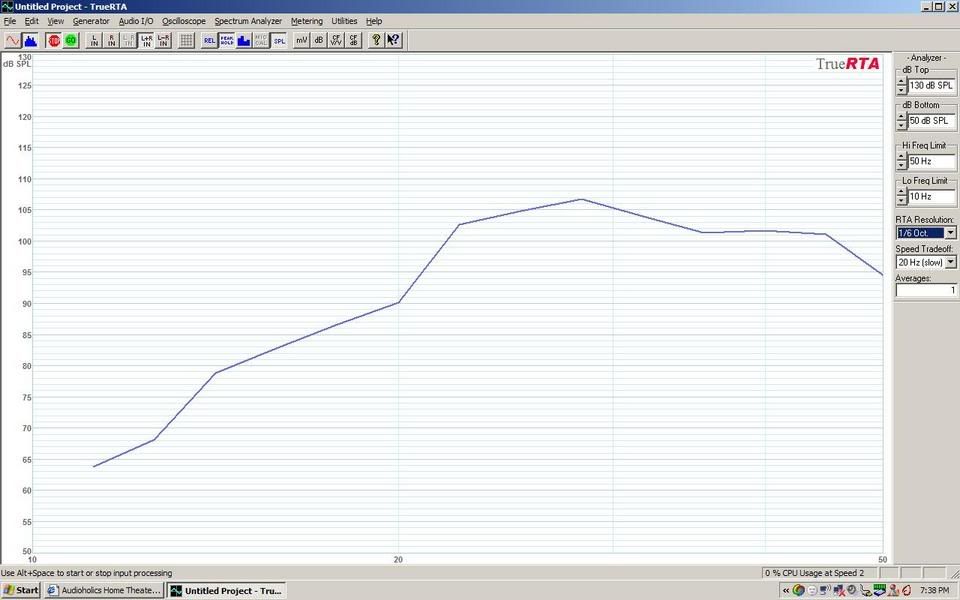

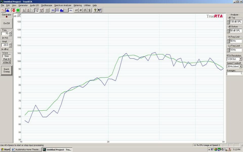

Ryan ... That was an excellent read. Here are a couple of graphs, as promised, of the VTF-3HO from 10 to 50 Hz. This is the both ports open mode. I have included the 1/24th octave raw sweep, and the smoothed sweep also. I also included a 1/24th sweep switching to 1/6th using the menu.
