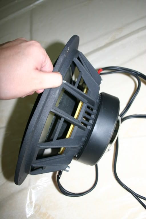

If you've disconnected everything from the Axiom driver, take the positve and negative from one front speaker and connect it to the plus/minus of the subwoofer driver itself. This, assuming it's not dual voice coil with a pair of connections. You should get sound from the subwoofer. The higher frequencies won't hard them subwoofer. Red - positive; black - negative.
mike c
mike c
I tried what you said, it was weak (probably because of only 120w from the receiver) but the driver works.
thanks buckeye, one less thing to worry about.

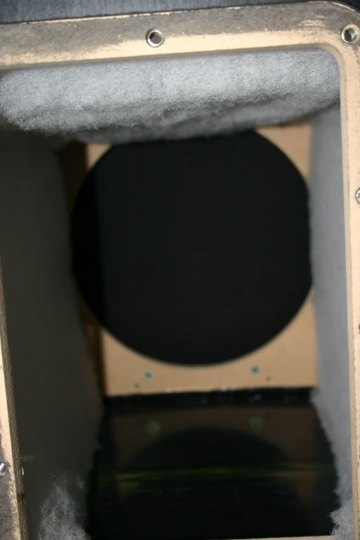

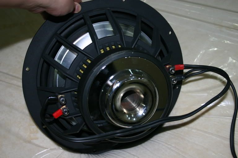

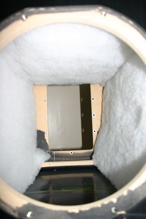

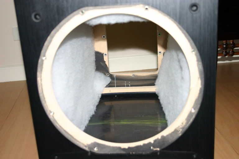

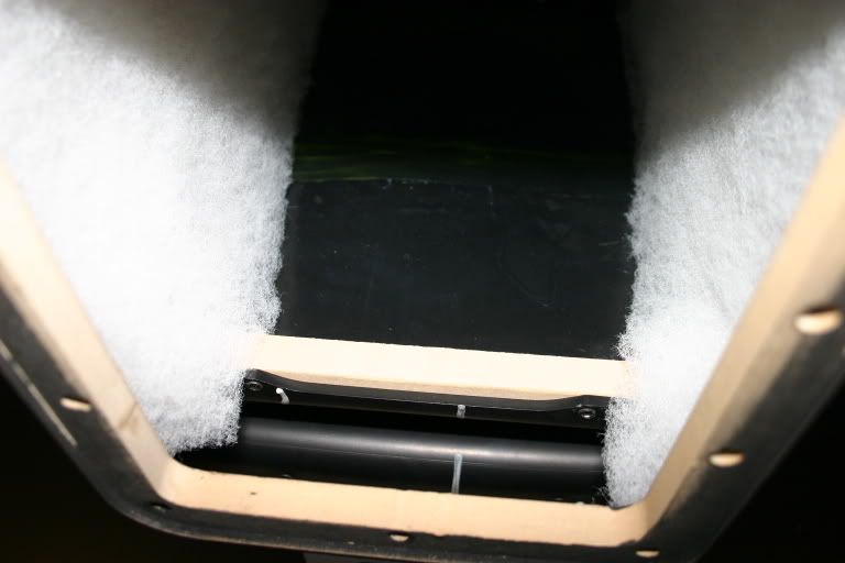

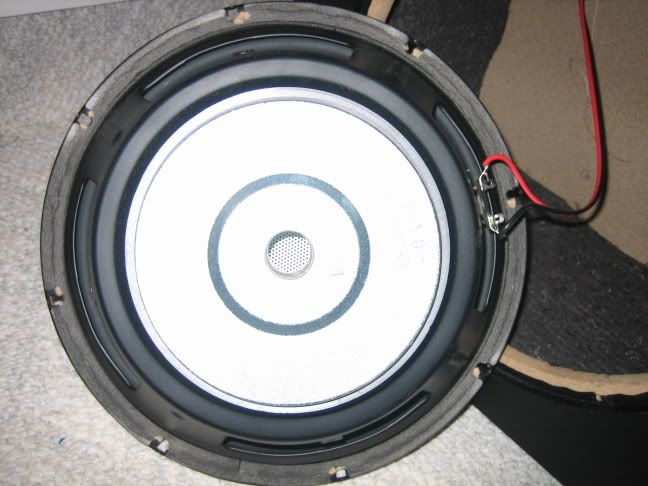

That is a dual voice coil driver. Can you take a shot from the side, as well as one of the inside of the cabinet?
Thanks for the pics!
mike c
mike c
sure. coming up in a few minutes ... here's the enclosure
sorry, blurry. will take some more.
mike c
mike c
hmm, cant seem to take a good picture.
more enclosure
side view

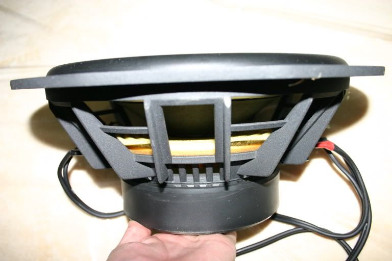

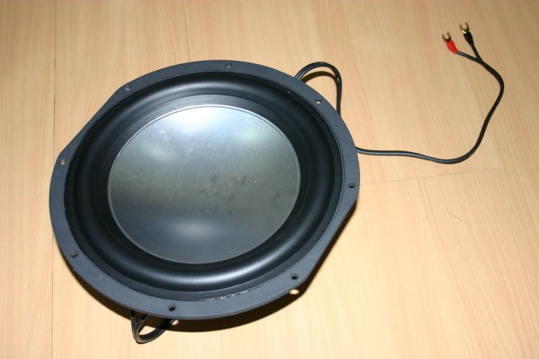

Mike,
Nice pics. I wanted to see the driver from the side. It's not a tall as I would have imagined. Have you looked at the Velodyne driver yet? I bet it's a beefier driver, but I could be wrong.

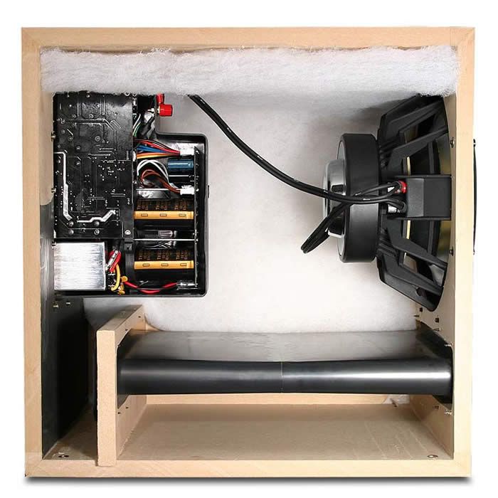

Sheepman was kind enough to give me a cutaway of an EP500. This does it a little more justice.
mike c
mike c
good cutaway sheepman. just for the record buckeyefan ... the amp has a pastic case for protection, you cant see or touch the stuff inside.

Sheep said:
Theres a picture of the DLSR driver on page 3 of the brochure.
and that, my friends, is how you make a FUGLY driver. (though aesthetics have nothing to do with performance) that driver is ugly both on the front side and the back side.
