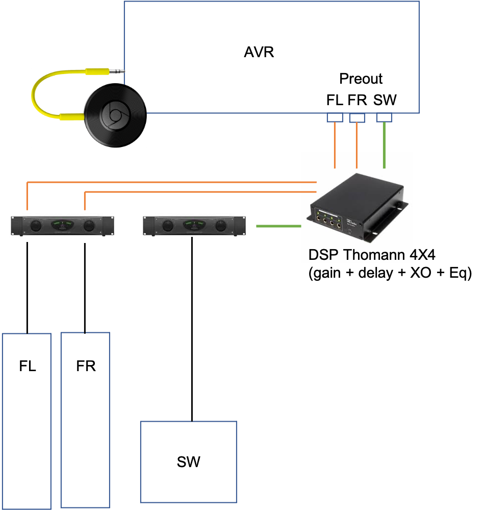

Before heading down the separates road I'd like to know what the speakers are (make and model numbers please) and the room dimensions and speaker positions.
Hello,
I built my speakers, based on Troels' Gravesen Design: HERE
Roughly, what it would look like. Note that I cannot push them wider because I just don't want to. I have already bookshelves and children toys taking 90% of my walls :D
My first impression is can you shift the Towers wider (and keep them away from the walls a bit) to accommodate a center better. I'm also thinking new equipment would be best purchased in pieces to see if you really need to go to separate amplifiers to get the results you want. Perhaps the Denon receivers being suggested would be enough power; and the system would be vastly less complicated and less costly. If they are deemed not suitable, then buy the separates after your in home listening tests are completed. Using the $$ currently destined for the separates could probably buy a better Center and or Sub.
I get the message. For sure, when I have the AVR I'll listen it without all the separates. If it's enough, then perfect! Every € that can be saved is welcomed :D
@lovinthehd @PENG @ryanosaur @Verdinut @Eppie You guys are just absolutly awsome!!!
Thanks a lot for being patient and doing some tests for me.
I could use the AVR only, true. And honestly if it does the job I will. The only problem is if it doesn't meet my expectations. Then I would like to be able to do Eq + XO the way I want and have power without distorsion with PowerAmps.
As @PENG mentionned, if it is possible to have "large" on main speakers and LFE + main on subwoofer with HPF to the highest frequency possible and let the external DSP do the job on "straight"/"pure"/"pure direct"/ "whatever nonDSP mode" , it's clearly all that I need.
