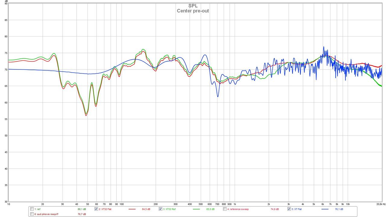

That's exactly right. They were done a big favor in that study. As a result, they completely changed the way their RC works with XT32. Here's a comparison somebody did between XT and XT32, measuring the pre-outs:
As you can see, XT (blue line) does diddly in the low frequencies, where EQ is needed the most. Then it goes nuts in the high frequencies, trying to correct hundreds of tiny little dips and bumps (which mostly wouldn't be audible anyway) most likely only making the sound worse.
XT32 on the other hand, goes after the bass frequencies with much higher resolution giving it a much better chance of providing a smooth room response at those frequencies. At higher frequencies, it transitions to much broader, smoother "tone control" type changes. Those are unlikely to harm the sound of good speakers (with smooth directivity curves) with the correct target curve (though, determining that is obviously the hard part) and could certainly make them sound "better" in a preference related way for individuals (a really good speaker that's just a bit bright could have the highs brought down a bit, etc). I have no doubt XT32 with a good custom target curve appropriate for the speakers being tested would do quite well in such a study today.

I don’t see how that graph shows XT32 (green) does better than XT (blue)
There’s a big trough in XT32 between 30-70Hz. And then after that, it looks similar for both XT and XT32.
I think XT32 does worse than XT or about the same.

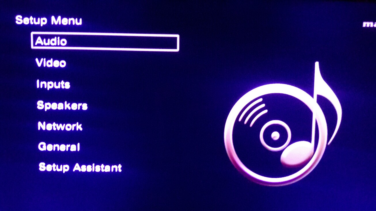

Setup button on the remote which brings up this screen.

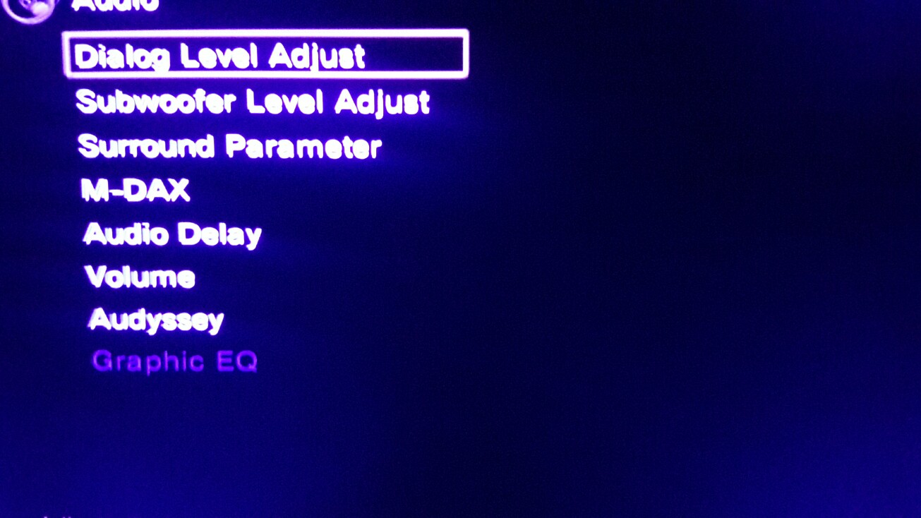

Select "Audio", which brings up this screen.
Dialogue level adjust is the first selection at the top on my Marantz SR6011.
The "Dialog Level Adjust" has been renamed to "Center Level Adjust" in newer Marantz/Denon receivers. In the high end Denons (Marantz as well I think) there is a "Dialog Enhancer" that only increases the SPL for some frequencies, and there is a thread/post about this in this forum this spring/summer I think.
