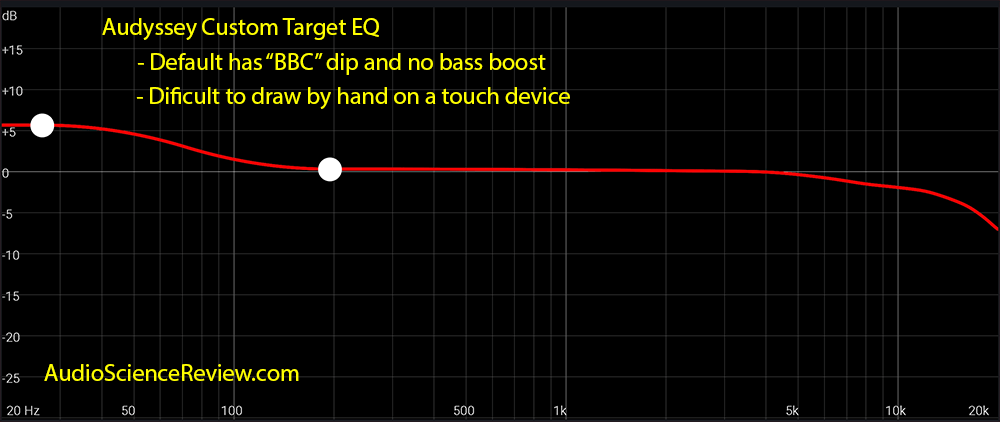

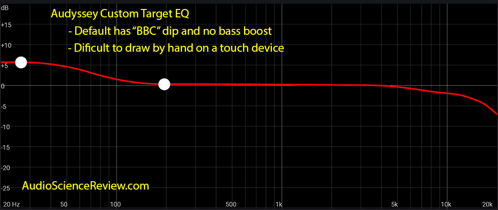

The X4300H did make it to the App compatible list so before you give up on Audyssey, I suggest you spent $20 and give the MultEQ Editor App a chance. You will be amazed with the results simply by doing the following basic things with the App:
- Disable MRC
- Limit the EQ ranges to below 1 kHz
- Customize the target curve for the sub channel(s) by tilting it like the so called Harman Curve.
- Disable MRC
Audyssey Room EQ Review | Audio Science Review (ASR) Forum
Audyssey can EQ down to 10 Hz but we can't really hear frequencies that low, and I know you know that already.:)

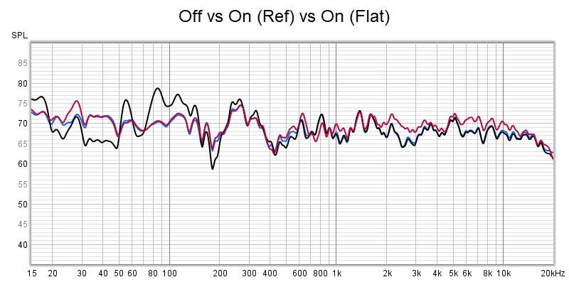

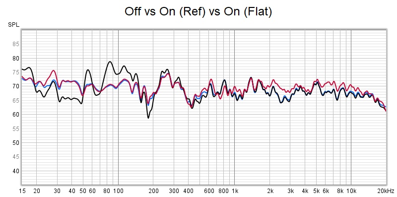

Without the App, you an still get the bass back by increasing the sub level for a few dB. There would still be an issue of the elevated high but I don't think it is an issue for people with some hearing loss in the HF unless you use the Flat curve.
Below is one plotted right after a run, without any tweaking with anything, no app.. You can see the loss of bass due to room gain in the 70-130 Hz range, and that could be what people complained about, the "thin sound". With the App you can get it back, without, you can bump up the levels though won't be as smooth.

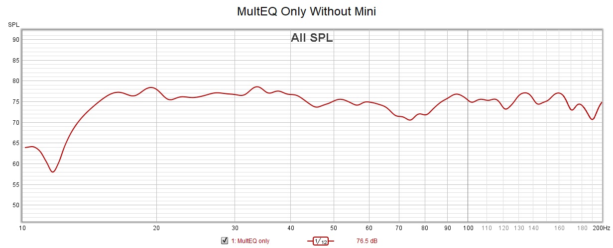

My living room along with the placement of speakers as well as subwoofers is not optimal, sad to say, but being able to disable the MRC dip and limit the EQ range would be very nice to try out.
Currently I've used REW along with PEQ on my dual SVS SB-3000 subwoofers to try fix some issues in my living room by applying the PEQ after Audyssey, including changing the crossover, to make it flat without DEQ enabled. More easily said than done, I'm afraid, with limited available placement. This was a major reason to add room treatment, while nice, is not a complete solution.

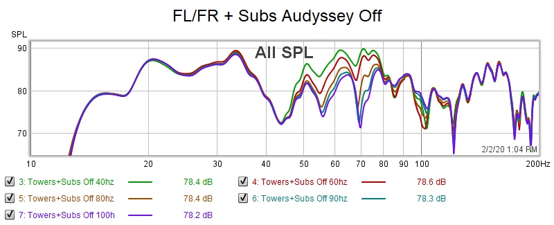

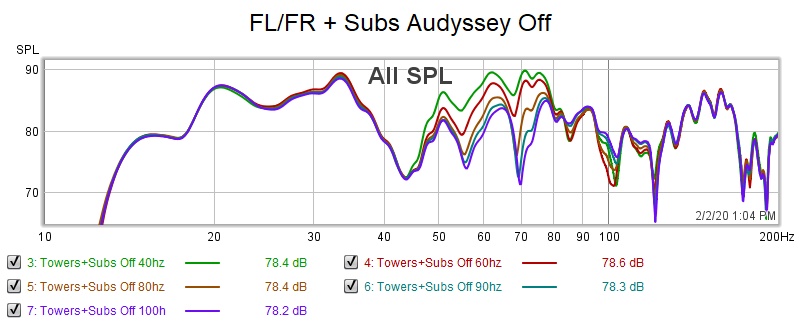

This is what I have to start with, no room correction or anything.

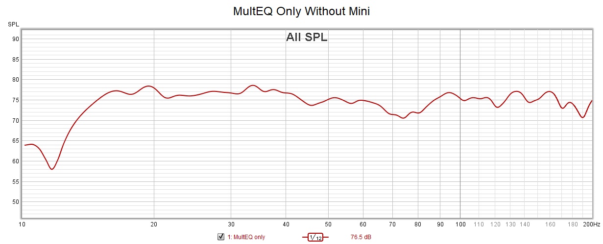

That's pretty bad, by any standard, lol. However this is where Audyssey got me with no additional tweaking.
That's a huge improvement, but it did leave my bass sounding a little thin, I think due to that dip between about 40 and 90 hz.

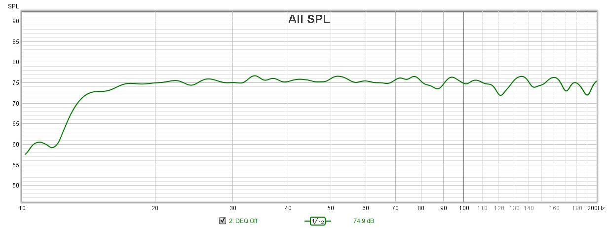

This is where REW and a calibrated mic becomes very useful. Once I could see what I was hearing (or not hearing in this case) it was pretty easy for me to use the app to finish tweaking it so I have a more even, linear response.
No more weak bass! Without some way to measure what was going on tho, it's just a crap shoot or guessing and our ears just aren't sensitive enough to zero in on exactly what might be resulting less than desired performance. Based on my experience Audyssey did seem to neuter my bass so it's totally believable. However it wasn't as bad as I thought and was pretty easy to fix with the right data.
