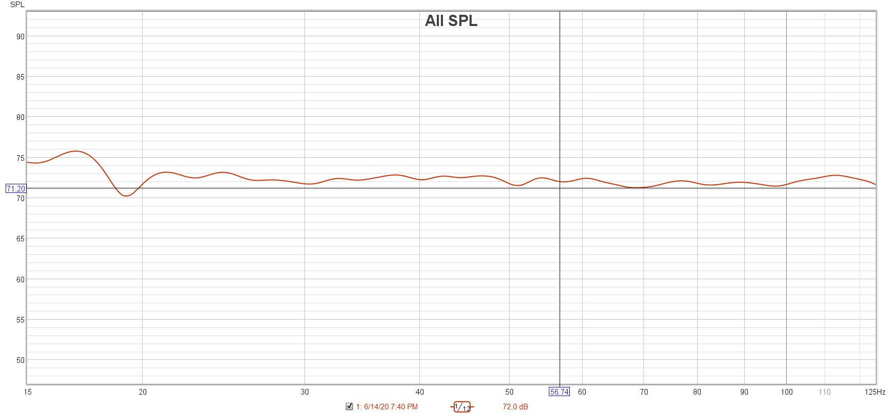

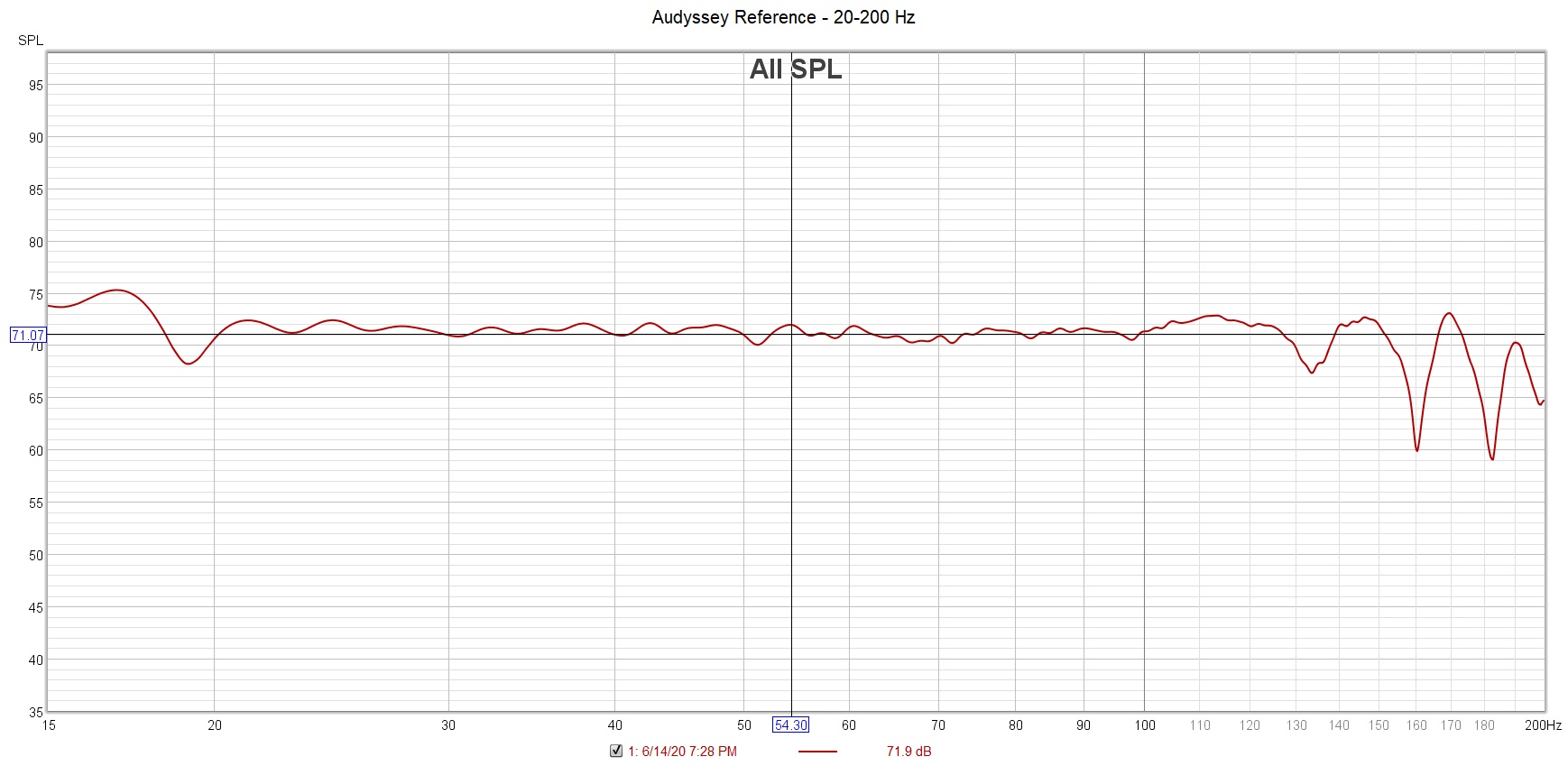

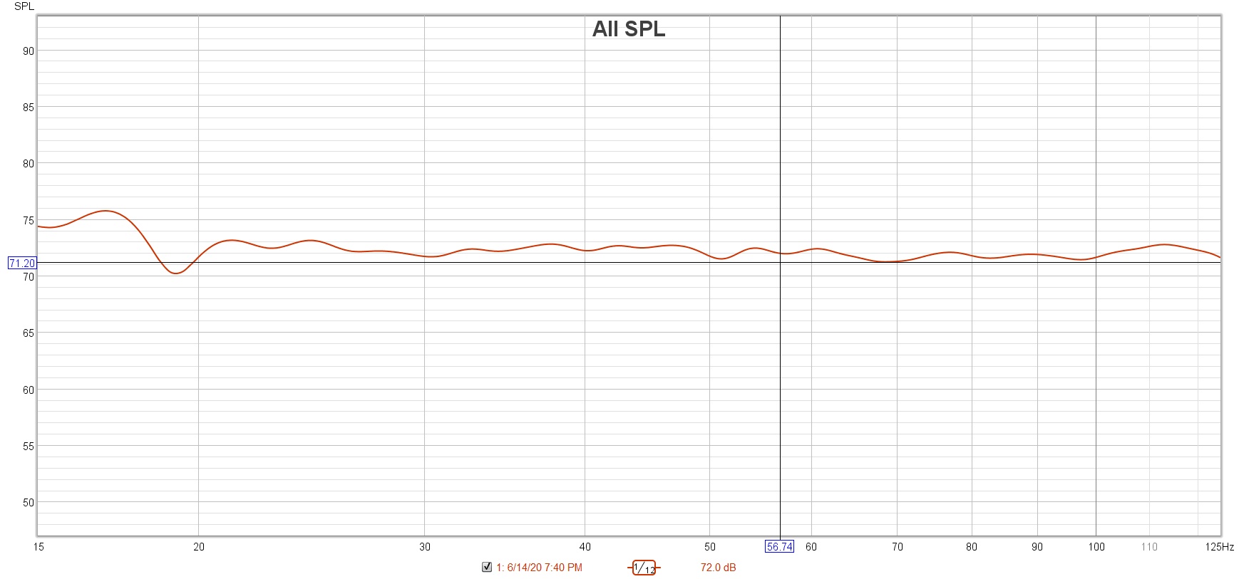

1) L+R+Sub (The L+Sub and R+Sub are just as good if not better)
I want to show this one first because I limited it to 15 to 125 Hz where Audyssey seems to be most effective. You can see that with 1/12 smoothing, the FR is within a little less than +/- 1 dB. I have never seen anyone posted better results than mine in this range. I did spend time using the MultEQ Editor App to tighten things up. There is really no need to so it though because I doubt anyone can hear much of a difference between +/- 5 vs +/- 1 dB in this range when watching a movie or even music. I did it because I had time and it was fun.

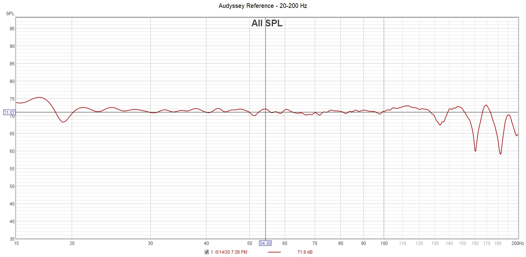

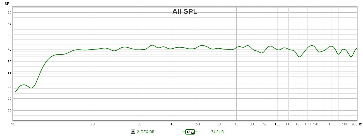

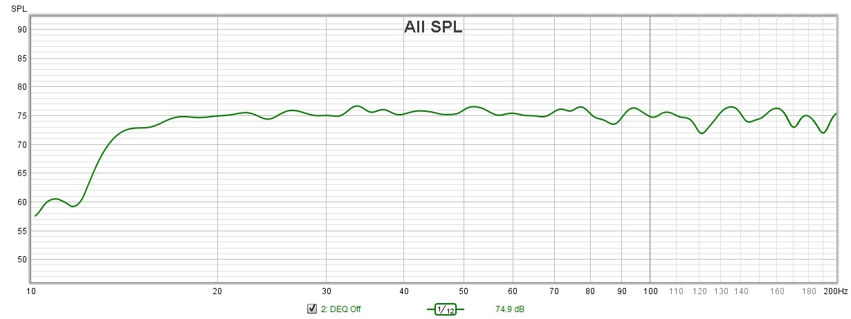

Now the 15 to 200 Hz range:
This one has no smoothing at all, I did it to see how bad those narrow dips were above 125 to 130 Hz. You and I both know that no REQ systems, auto or manual can eliminate such kind of dips so there isn't Audyssey's fault at all.

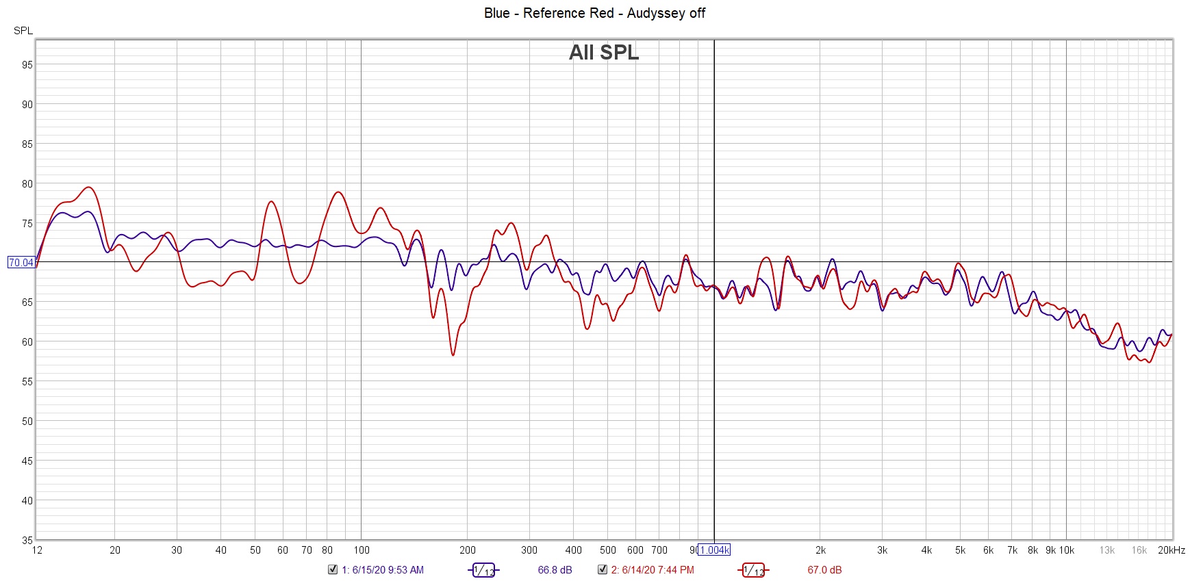

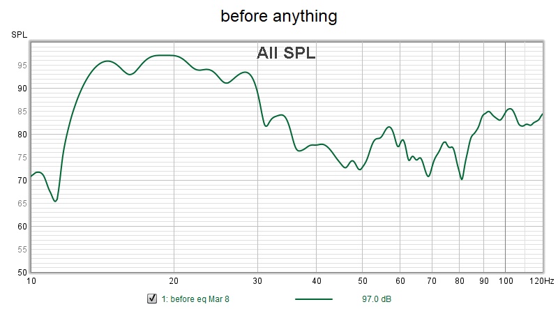

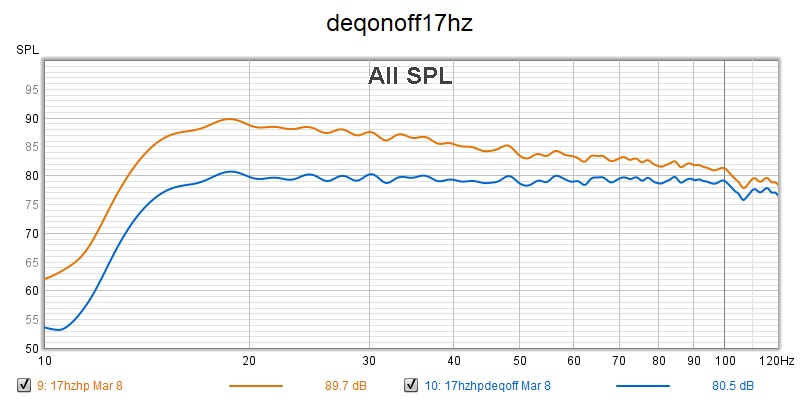

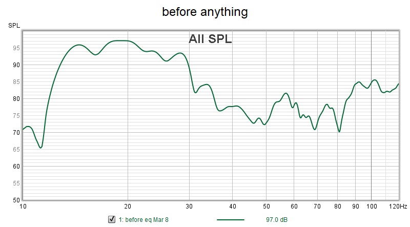

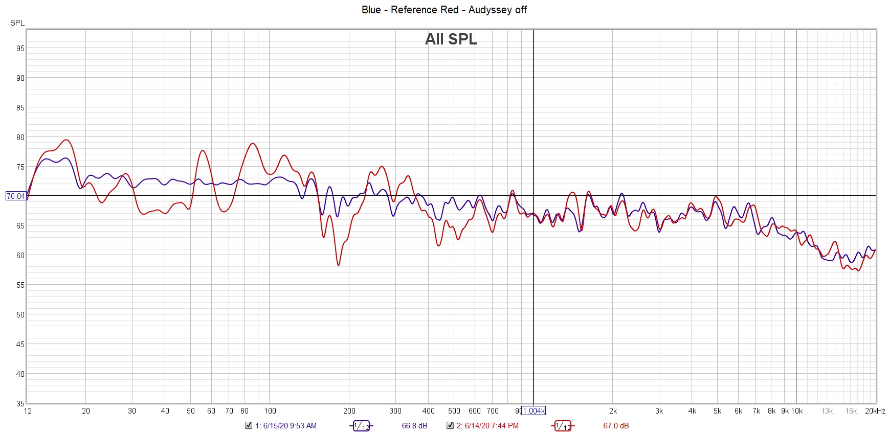

The one below just show how bad the results were without using Audyssey (obviously that would apply to my room and speakers only):
Regardless of the measured results, if I didn't prefer the sound with Audyssey on, I would have just disable it.
