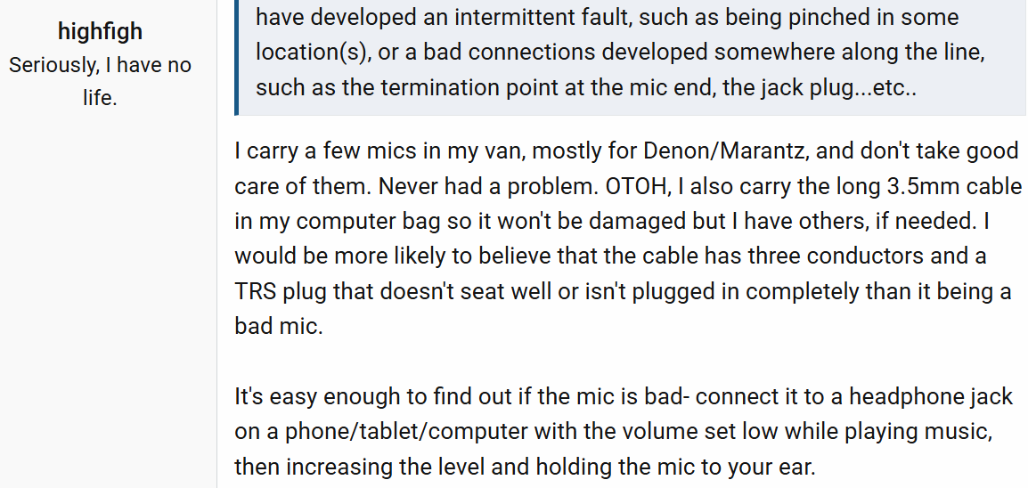

Here also, after many runs a bad Audyssey mic.
I bought a new Marantz Cinema 30 (Feb 2025) and after a few runs I thought the C30 died on me, as running Audyssey was not possible anymore.
Sent the Cinema 30 in for "repair" and they supplied a new mic, nothing wrong with the C30 they told me.
Now a few months after the new mic, this mic will not detect the subwoofer, it will say the SPL is 30dB and I must set the sub louder, but even on full volume, it wil not meassure more then 30dB.
When I tap on the mic, or scream loud, it will react but will not go higher the around 40dB.
I ordered a cheaper new unit and will try that mic, if that is ok I will get a new mic but first I want to know if it is the mic or the C30.
If it is the C30 I will get the same problem with the new mic, if it is the mic it will do a new Audyssey run ok, let's see what will happen.......
Edit:
After plugging in the mic to my laptop headphone socket, and playing music, but not hearing music through the mic as suggested, I tried it and the mic worked again o_O
Maybe this playing a signal through the mic made it wake up (?), but I am happy its working
