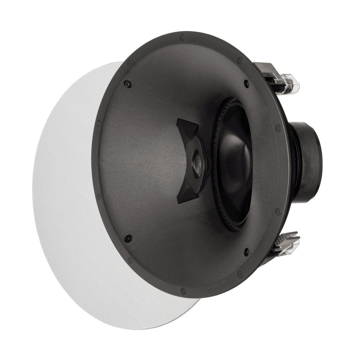

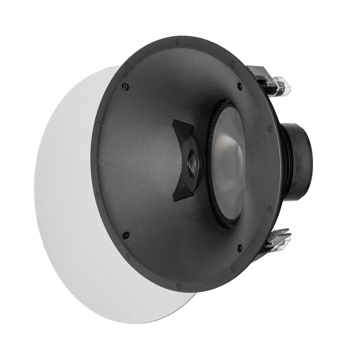

I know several members here with very discerning demands for their front speakers who use mismatched speakers for the Surrounds. Likewise, many friends here use different speaker for Atmos (those using in-ceiling for example, rarely have the option of matching their mains).
