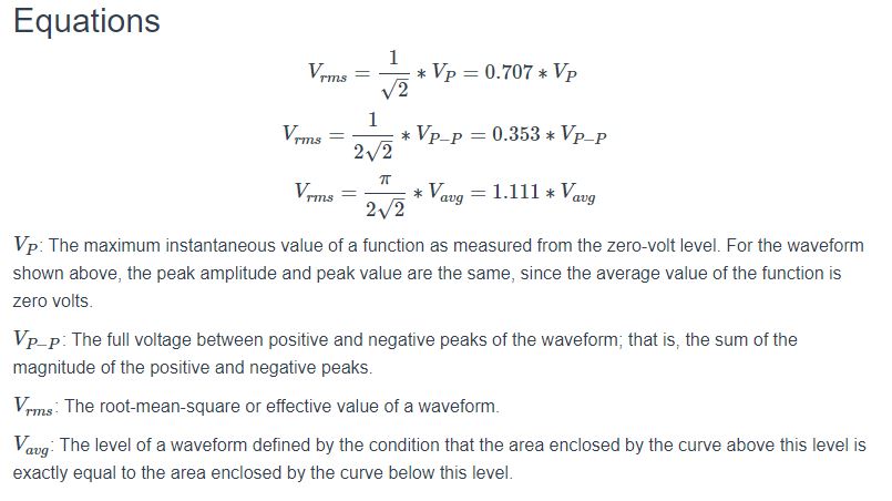

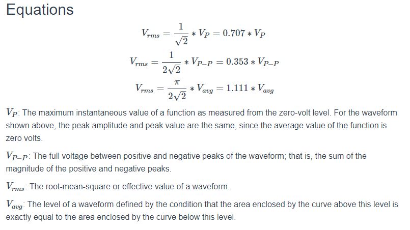

I saw that. Nowhere it mentions RMS power or how it is derived. Obviously you cannot tell me how, what products are used like Vrms or Irms.
I see that Vrms is .707 of Vpeak so the current must be the same.
I guess I could get peak power just by Vpeak x Ipeak. Would that be used to get RMS power? Or is there are secret function?
Could you tell me what is the power with 10 Vrms and 10 Irms is? Or that is , 100W but is that RMS or just continuous .5 of peak power? After all, RMS has a fixed function for sine waves. I can tell you that power is not .707 of the power peak so it cannot be RMS.

RMS is a math concept used to find the DC equivalent of waveform. For a sine wave it's 0.707 of a waveform value, V or I. Average power is derived from Vrms and Irms values (P=Vrms x Irms). Amplifier advertising regularly states power values in "RMS" but these are not "RMS Power" but "Average" or "Continuous Power" values to not be confused with peak values often used to inflate numbers. (See: https://en.wikipedia.org/wiki/Audio_power#Continuous_power_and_"RMS_power"). Average power is the RMS Voltage multiplied against the RMS Current. Thus "100 watts RMS" means 100 watts average power not "RMS Power" as I gather this is what you're actually getting at as opposed to peak power ratings used to inflate sales numbers.

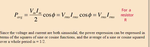

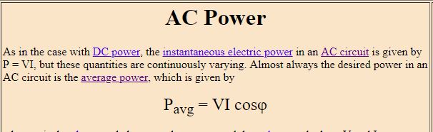

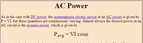

Here are two grabs from Hyper physics under RMS. No mention of RMS power but exactly what the above calculations proved, AVERAGE power.
RMS has only one meaning and it doesn't mean average.
P avg= V rms X I rms; average power, not RMS!
Yet, another. Since RMS is .707, guess what happens when you multiply .707 and .707 =.5 (average)

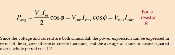

RMS has only one meaning and it doesn't mean average.View attachment 28745View attachment 28746
