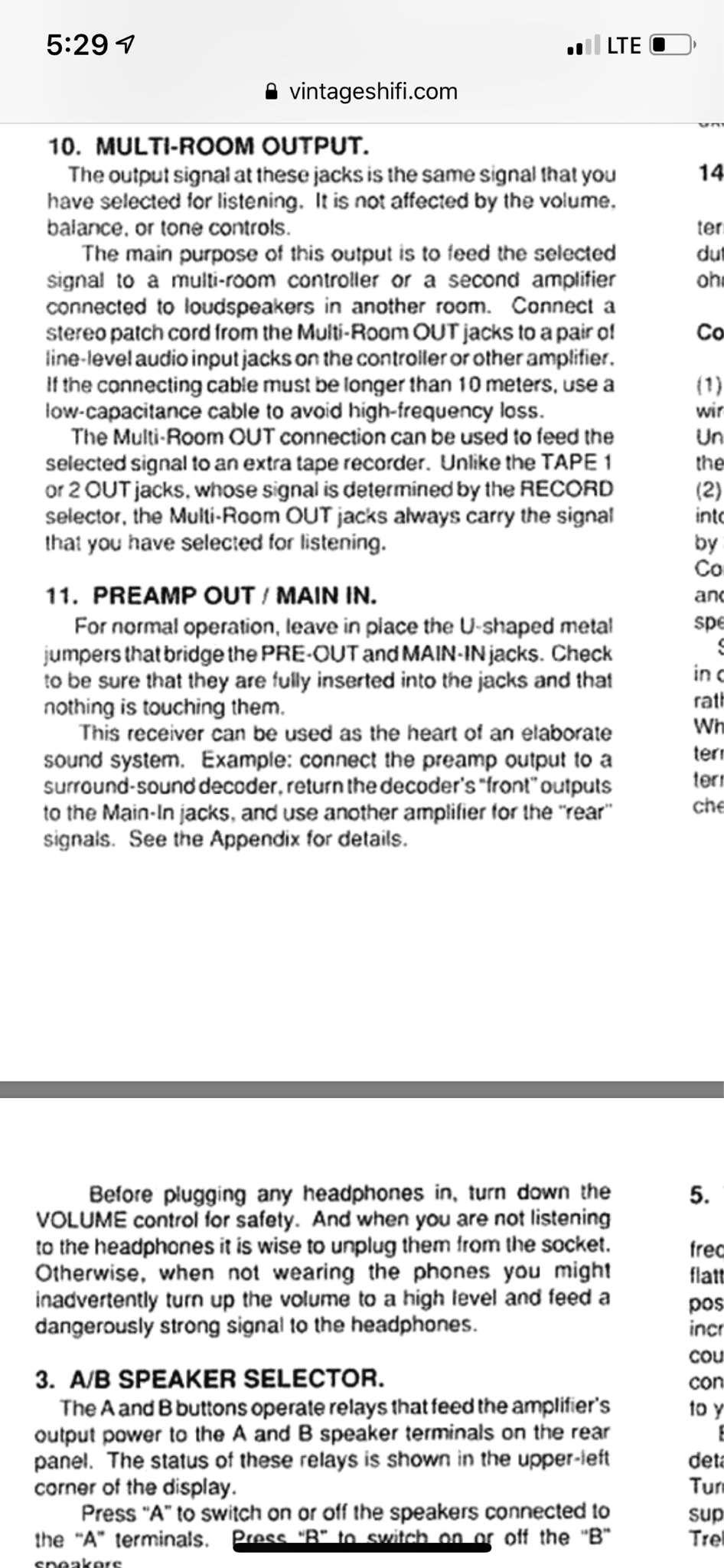

I was looking to see if my receiver will power speakers and send a pre-out signal at the same time. That’s still unanswered even after emailing NAD but it did find this article on its power output rating. Best $20 I’ve spent in awhile.

Most avrs have live pre-outs at all times....can't you test it for yours?
TankTop5
Ratings
45
#99

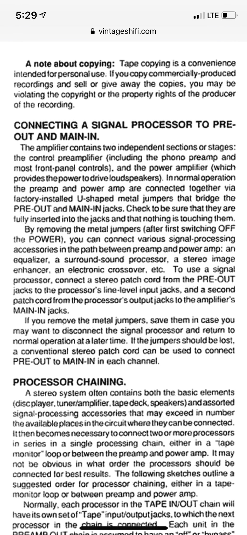

I don’t currently have equipment to test it with but I think I found the answer. If I’m reading this correctly I cannot use the pre outs for a sub while using speaker A/B and the system is designed as a loop to add an external processor.
Ratings
5,058 18 47
You could use a splitter on the pre-out main-in to get signal for a sub...
