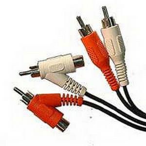

If disconnected, sure. If you split the signal out of the pre-outs, then that would allow you to reconnect the amp section of the Nad and another connection for a sub. Use y-split rca cords for example...
TankTop5
Something like this?

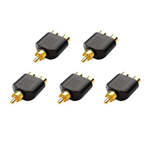

Or this would be even easier.

Just be sure to check the input impedance of the amp and powered subs before buying to ensure the input levels will be appropriate after the signal is split.
