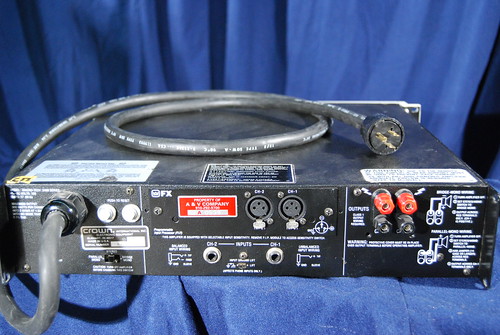

When it comes to amplification you need to look at what is exiting the rectification stage after Xformer and the capacitor bank... If that's cleaned/conditioned... Than a power conditioner isn't going do anything for it in 'normal' operation modes. That is the utility power isn't compromised.
Now that's a power cord...
