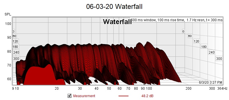

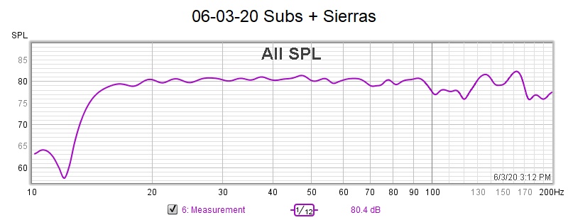

Just getting wrapped up for today. There's more work to do with Audyssey above 100 hz but I need to do some homework on ratbuddyssey and figure out how it works. The app by itself did help a little bit, but tight, precise adjustments aren't really possible trying to draw it by hand.
For now I have Audyssey on reference, DEQ on, RLO -10. Direct and bypass seem kinda dull. I'm preferring Audyssey's adjustments so far. This is just the start tho. My main focus today was getting my bass dialed in.
Mpsafranski
That’s impressive. I have a suck out at 80-90 I haven’t been able to fix, room issue. That’s frickin unreal what you’ve got between 15-100. Are those Hsu 15 inchers?

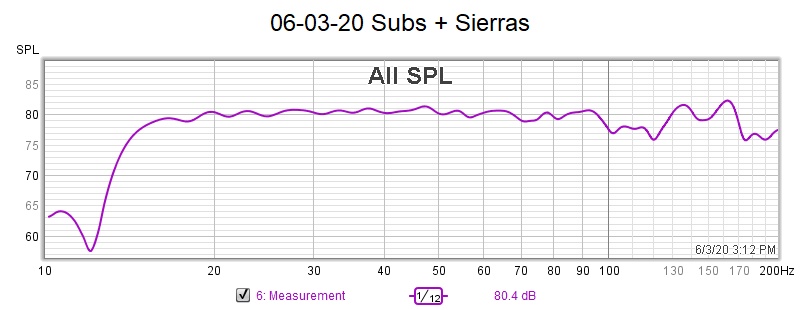

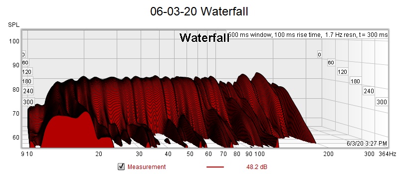

View attachment 36816View attachment 36817
Seriously, that is impressive. It looks like +1.5/-1dB from 15 to 95Hz.
What does it look like if you get rid of the smoothing? I was thinking at low frequencies smoothing hardly makes a difference!
Yeah, you're right. There isn't a whole lot of difference below 100 hz with no smoothing, lol.
@Mpsafranski yeah, they're HSU VTF-3 MK5s and worth every penny I spent on them. That sweep is the deepest extension mode (1 port plugged, EQ1). That's how HSU recommends setting them when running room correction so I finish dialing them in with the Mini that way also. Then when I'm finished I pull the port plug and switch to EQ2. It's a little less extension but there's a little more mid bass output and headroom.

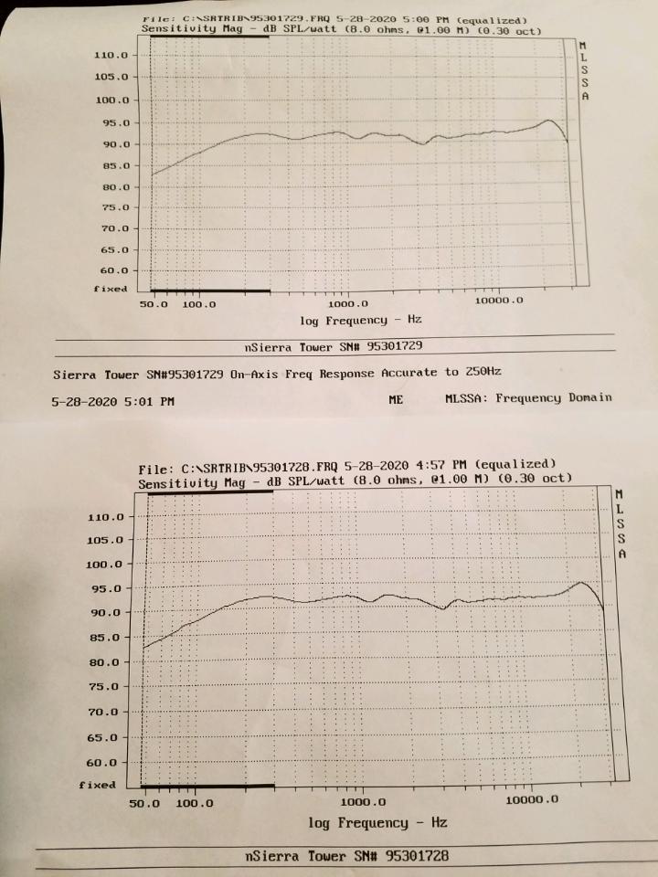

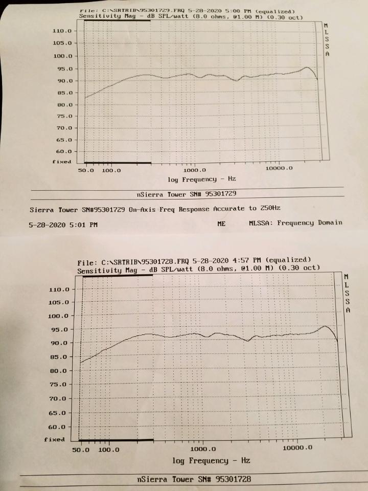

Here are the charts they sent with the speakers.
I'm seeing a tilt to the upper end. That would definitely explain their more forward nature.
The high frequency upward tilt is far too high in frequency (not to mention too small in amplitude) to impart a 'forward nature' to the speakers. The 'forward nature' is more likely to be seen in measurements of the upper midrange both on and off axis.
The problem is not the hump. If you look, that tweeter has a rising response above 6 KHz it is small but audible. This is similar to what a lot of mc cartridges do. The 'golden ears' call it 'air'. I think all Ribbons have that response. I personally don't like it. I note that when Dennis Murhpy uses that tweeter he shunts it with a small cap to prevent it. It is enough to give a forward sound.
B
Beave
I wasn't referring to the hump. If you can hear a 1-2dB gradual rise from 6kHz to 20kHz then you must be have excellent high frequency hearing for your age and/or you're in your teens or twenties.
The 'forward' sound of the towers is not in the highest octave. It's hard for a speaker to be 'forward' in an octave in which no fundamentals occur.
Maybe I should clear this up. By "more forward" I mean "not as laid back" as the Ultras. I hate to admit it, but they were a bit tame.
