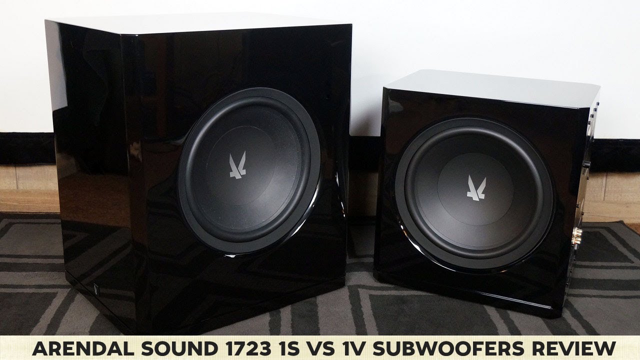

After having reviewed three of Arendal’s subwoofers, I like to think I am pretty familiar with their design philosophy and performance targets. I have dealt with their massive $3k flagship, 1723 2V (Audioholics Arendal 1723 2V Review), as well as their smallest and most affordable unit, the petite 1961 1S (Audioholics Arendal 1961 1S & 1V Review). I think I know what to expect from the middle of the pack 1723 1S and 1V, but I have decided to take a look at them anyway so readers can get a look at these subs from our informed perspective.
