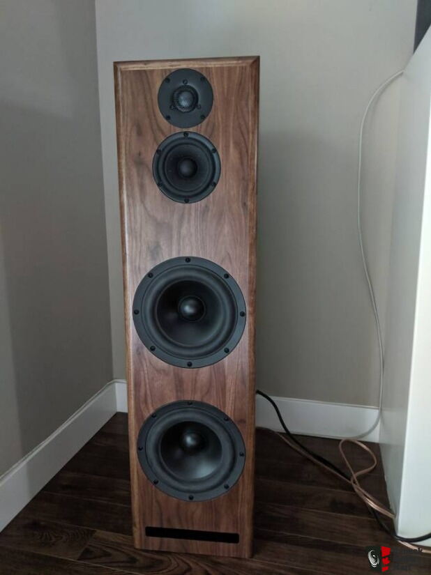

So what do you think these are? It say Custom Speakers on the Ad but nothing else. No grills. Look kind of interesting? Or Trash ? :) Looks like there are holes for grills. Not sure if that is easy to DIY?
They look to have low quality drivers ... and have sort of an overall cheap look ... one would have to really listen to them, because the crossover work may also be limited.

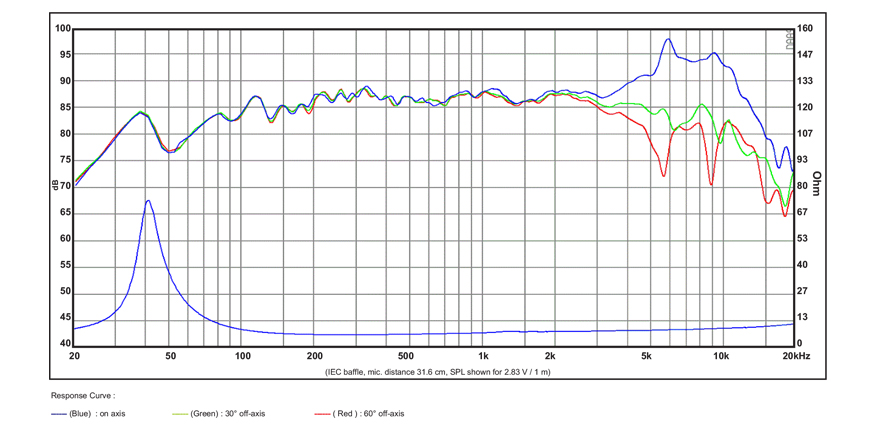

Not quite as linear down low as I would like to see with that ~6dB dip just below 50Hz. Not a bad driver otherwise.
That SB driver will reach an F3 at 30 Hz in a ported cabinet, not -6 dB at just below 50 Hz.
In my book however, if a driver doesn't dig below 30 Hz at -3 dB, it's a simple woofer not a sub.

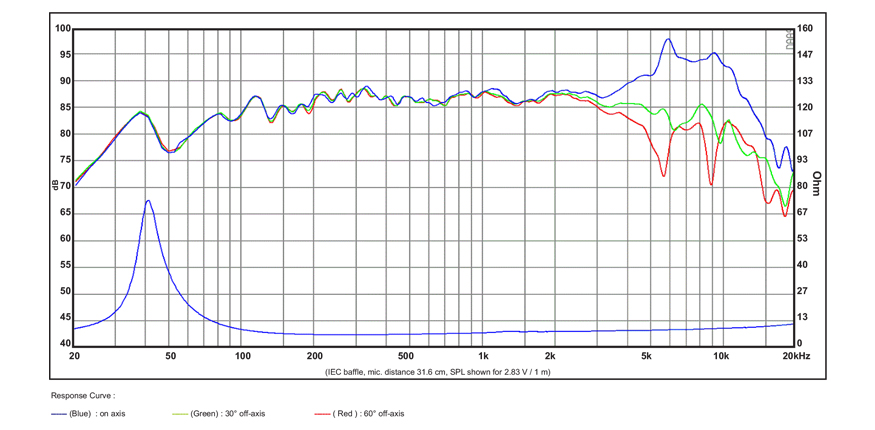

That SB sub driver will reach an F3 at 30 Hz in a ported cabinet, not -6 dB at just below 50 Hz.
I was commenting on the supplied FR chart with its big dip in the response, not driver or speaker rolloff.
Sorry about the misunderstanding. I agree with you that there are drivers with a more linear LF response. But the shown response was actually taken using an IEC baffle,
which is basically just a massive wall which separates back and front side of the speaker. The IEC-baffle is defined in a size that allows thinking of it as being infinitely large. This assumption allows viewing the two sides of the membrane (front and back) as acoustically completely separated.
Here is also the response with the IEC baffle, of the 5 inch SB15MFC30-8 which I use for the surround speakers in my HT. It also has big dip at 50 Hz but used for frequencies above 90 Hz up to 1900 Hz crossover frequency, it has a smooth response. It also makes an excellent mid-range driver for a 3-way speaker:

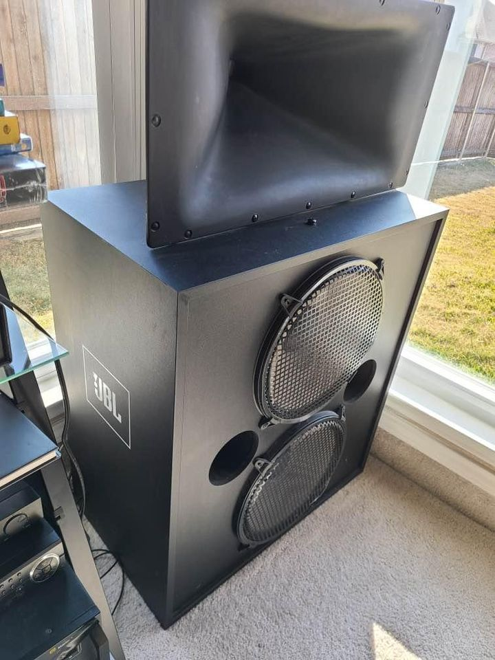

F
fmw
I wouldn't bother with them unless the performance is verified somewhere. Just because something is pricey does not mean its good, and this is even more true in the audio world.
For sure. Price is not good indication of either quality or performance in the audio industry.

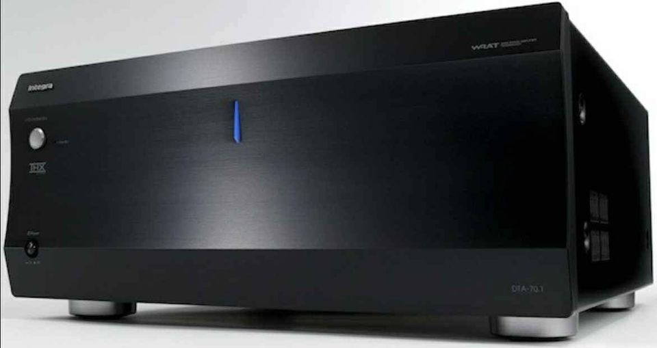

Better not show this Onkyo Integra to @}Fear_Inoculum{; he might want to add it to the growing amp collection. :D
C$1400 for 9x150W into 8 ohms (185W into 6 ohms, 400W peak into 3 ohms).
For these, sometimes I think the measurements are not all channels driven. I wonder for these and the Marantz amps, other than the appearance, why for this price someone wouldn't just get an ATI built Monolith 7x or comparable which are 200WPC?
But they do look good
The manual is pretty good for this model. Power specs are with 2 channels driven and it gives other power specs at different distortion levels and impedances. I think the price is little high given the retail value.
