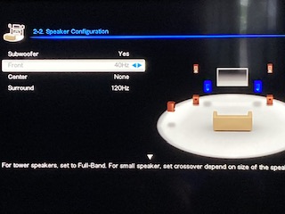

Not sure what to set mains to right now 40hz I had tried 60/80 .
AVR still needs to recreate the LFE, even if as simple as applying the XO, and downmixing to 2.0 will loose a lot of original LFE signal..

what should I set fronts to 40/60 or 80 hz ? I tried full range but they don’t seem to produce enough bass for that.
Spectrum app is 2.0, I’ve noticed basketball and certain sports games I get a lot of bass for some reason. Almost as much as Netflix movies . Can’t understand why cable companies are too cheap for 5.1 audio on there app ?
what auto eq set them too
what auto eq set them tooView attachment 68049
Not really sure what is the best option for you. 40hz is pretty low even for big towers. Best guess is either 60 or 80hz.

I set them to 60 I’ll try 80 later , these fronts.

Subwoofer was getting bass signal even when the avr set fronts to 40hz and full range on prior calibrations. Despite this sources only 2.0 but a few surround modes shut sub off on full range. I set fronts to 60 now.
By default the sub always gets the LFE channel on most setups - if you have a crossover set (ie: mains are not full range) - then the sub "should" also get the part of the frequency range from the Mains which is below the XO point.
But when the AVR is set to "stereo" - then bass management may or may not be involved, depending on the AVR setup.brand etc...
Most AVR's also have a Direct or Pure-Direct mode - where the channels are passed through untouched to their respective speakers - typically that should disable XO's and if fed a simple stereo signal should output only to L&R.
The other thing to watch for, is how the sub is hooked into the system - so far I have assumed the sub was connected to the Sub output of an AVR, but lots of subs have alternative options - my Gallo sub has an input and an output for the L/R mains at speaker level, and then it acts as the crossover (adjustable for frequency, level and phase)...
If your sub is set up this way - with the XO being in the sub, then all signals fed out, will result in sound from the sub (depending on LF content obviously).
