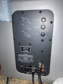

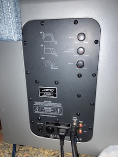

My other sub has those but they broke and i couldn’t find the parts to fix them. This is the main sub I’m using the other one is mostly turned off .

My other sub has those but they broke and i couldn’t find the parts to fix them. This is the main sub I’m using the other one is mostly turned off . View attachment 68112
So your adjustments are the Low Pass filter (cross over) - Phase and level/volume...
Just make sure the LP is set to the highest possible frequency, so the AVR can do its thing (the XO / LP will be in the AVR not the sub)... Phase is typically also handled by any of the more advanced AVR's - but may require experimenting with if your AVR doesn't do that.
