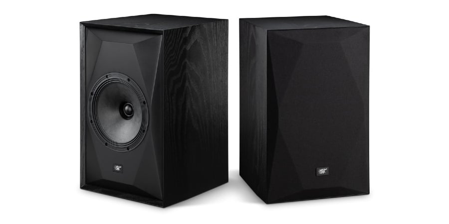

Alas Andrew Jones has finally done it? He designed a concentric loudspeaker that can play loud?!?
Andrew Jones and MoFi have launched the SourcePoint 10 loudspeakers ($3700/pair). The SourcePoint 10 is a large 2-way stand-mount speaker featuring a 10-inch concentric driver and 91dB sensitivity rating.
Editorial Note about Driver Sensitivity by Gene DellaSala
The other often overlooked advantage of employing a larger driver is increased sensitivity. We finally see a concentric driver speaker design from Andrew Jones with a sensitivity rating of 91dB. Most of the concentric Elac speakers Andrew Jones designed in the past have had a mid 80dB sensitivity rating limiting just how loudly they could play without entering thermal compression. Seeing a high sensitivity design like the SourcePoint 10 is a very welcomed attribute.
Read: New Andrew Jones MoFi SourcePoint 10 Concentric Loudspeakers

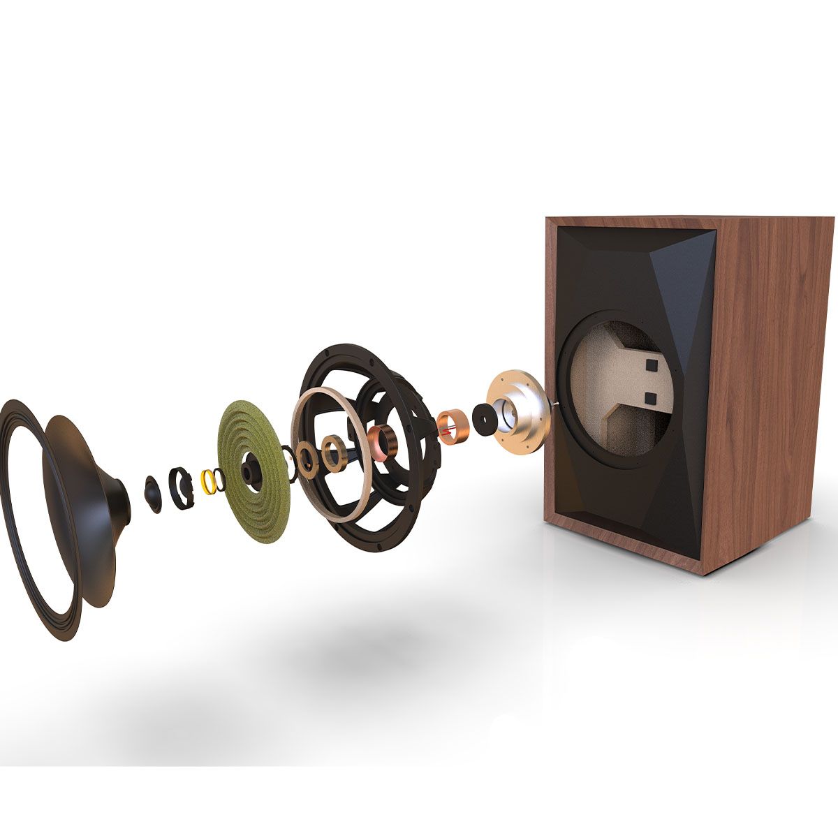

Unlike the conical shape of some coax drivers such the Eminence, that woofer appears to be much more of a contoured waveguide. Has that resulted in a good directivity match, a typical challenge in large diameter woofer two ways?

The Tannoys are very different. They are sensitive, but they probably won't be nearly as neutral as these coaxial drivers, if these are anything like Andrew Jones' previous drivers. The Tannoys have always been measured to have a pretty rough response in comparison. The reason is that they are using a throat in the waveguide whereas the Andrew Jones coaxials all have had shallow waveguides, which don't load the tweeter as much and are therefore less sensitive but don't incur as much diffraction and so can yield a smoother response.

I had a pair here for a demo. And, of course i measured them. My plots were identical to Stereophile's--not too pretty and bright on axis, but very smooth off-axis. I listened with no toe-in, so the first arrival information was off-axis. But what I heard conformed to the on-axis plot more than the off. The actual sensitivity is 90 dB according to Stereophile and my plot. Still pretty good.
Actually that makes sense. I have found one of the issues when working with coaxial speakers is differences in the on axis and off axis response die to cone reflections from the tweeter output causing peaks and nulls. So yes, it is not surprising to me the off axis response would be best.
Paul Klipsch published a research paper on this years ago, I think in AES, where he investigated all this, and also the doppler distortion that arises in these reflection due to cone motion of the bass driver.
I was just a little surprised the brightness and mid-treble variation came through so clearly given that the direct sound and first reflections would have been smoother.
Erin's Audio Corner just published some measurements on the Mofi SourcePoint 10. His comments echo those about the highs being lifted on axis but Erin also takes the time to explain why the speaker was designed that way and how to correct for it. Overall gets a good rating.
