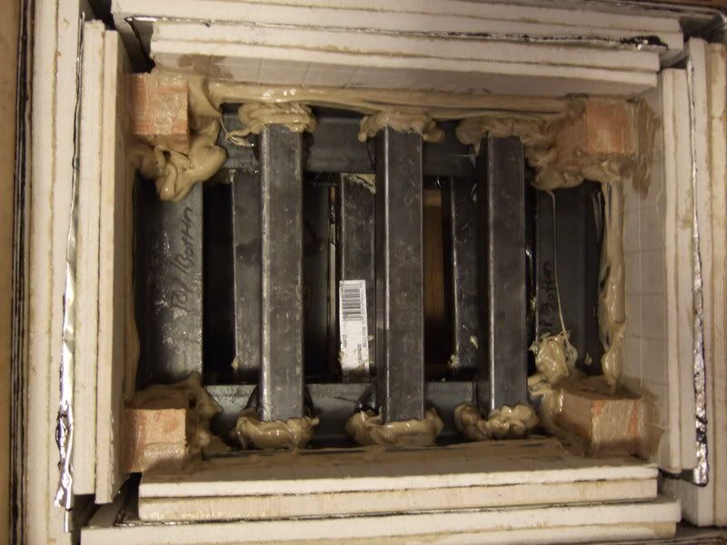

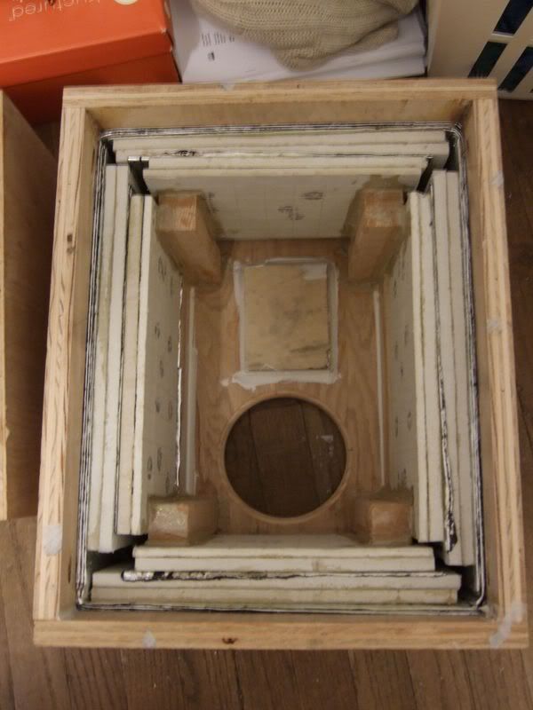

If you decide to scratch build cabinets, then please consider putting the effort into making them low in resonance. This means more than some bracing. One effective method is to use a standard material for the outer layer/exterior, such as 3/4" thick MDF or hardwood plywood. Then adhere 1/8" to 1/4" thick visco-elastic material to the inside, such as Dynamat or similar(Peel N' Seal - a roofing product available from Lowe's). Clean the aluminum foil facing with break parts spray and then score it with some sandpaper. Use a poly glue(such as PLH Premium Construction Adhesive, which comes in a caulking tube) to adhere a minimum of 1/2" thick Hardibacker brand fiber re-enforced concrete board to the visco-elastic layer. 1" layer is superior, obviously, but will increase weight even further. Use liquid poly glue such as Gorilla Glue or similar to glue the 2nd 1/2" layer of concrete to the first, if you want 1". Now use 1/8" thick 1" x 1" steel angle and run this vertically in at least 2 rows on each wall and continue it along the bottom and top walls. Apply to front panel, also. For the back panel, it may be easiest to only use the visco-elastic layer and concrete layer, then use spacers from the center line of the back panel to glue/adhere to the steel tubing that you will install as horizontal cross bracing. Adhere steel to the concrete using the PLH construction adhesive. Use steel square tubing and use metal epoxy to run steel cross braces every few inches. Note: use sand paper or other means to clean the steel at points that you use adhesive. The steel has a thin oxidized layer that must be removed if you desire maximum strength joints. Here is an example showing the layering of MDF/visco-elastic material/concrete and steel bracing: http://www.linaeum.com/productinfo/other/ascend_cbm170se_wmaxmod/9.jpg
-Chris
-Chris
A note of curiosity. How much does that box in the picture weigh after your modifications?
They likely weight 25-30lbs a piece.

I must admit for my first build with a 2 way the above bracing seems a little tricky to execute and I will most likely go with some internal wood bracing for now.
If you take your time measuring and cutting as well as gluing it is a doable project. The reason for recommending use of steel is because it is far more dense than wood allowing for a less dense bracing matrix and a audibly inert cabinet. Also, this allows for a smaller cabinet to be build since less volume is dedicated to bracing.
If you decide to go with a wood bracing method use of oak stock would be ideal. Also, to achieve the same results you would need to construct a bracing matrix that leaves no gap larger than 3" (ideally 2") in any direction on the XYZ axes.
Another example (do note there are two constrain layers in use in my build):
