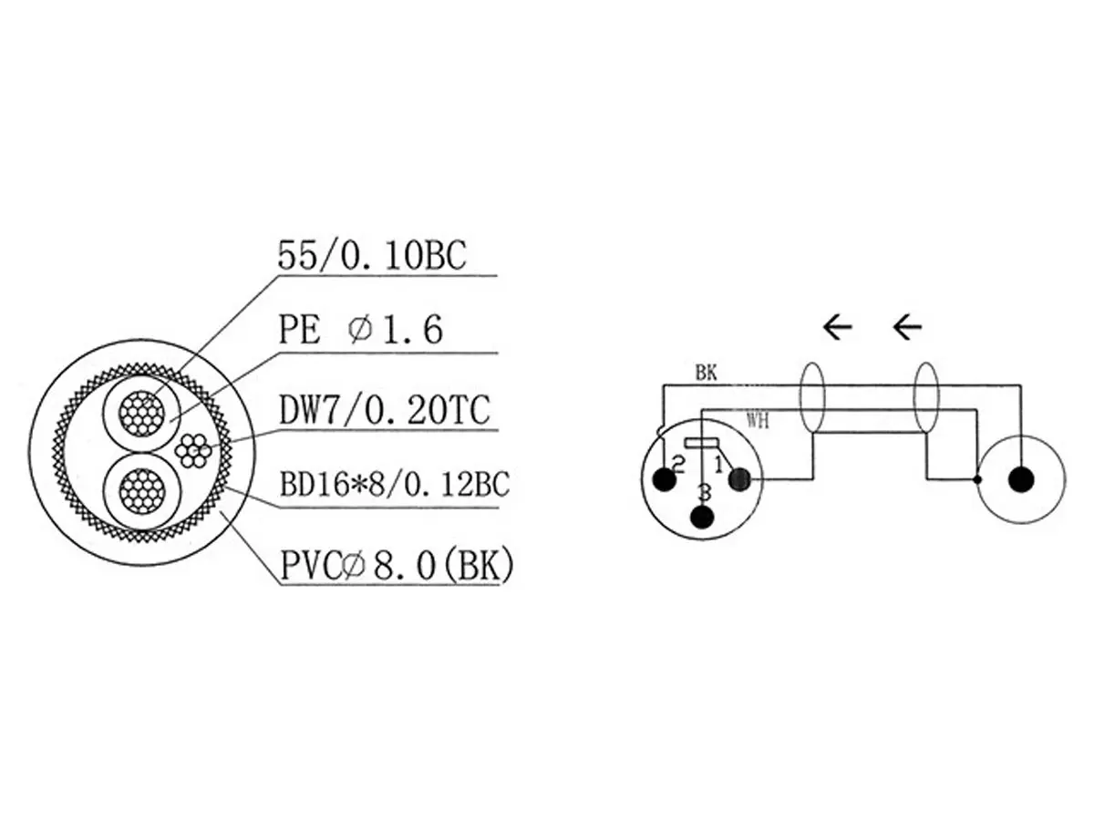

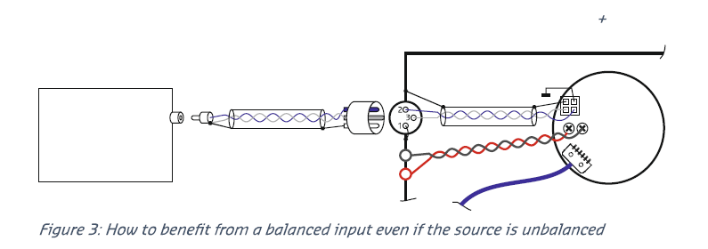

Since he seemed to have deferred that to me so let me try:
First of all, let's compare the MP cable's connection diagram to the one recommended by Hypex:
Monoprice:
Monoprice 6ft Premier Series XLR Male to RCA Male Cable, 16AWG (Gold Plated) - Monoprice.com
It looks to me Monprice does follow Hypex's recommended wiring method.
According to Hypex, the RCA to XLR, if connected correctly as shown the benefits would be almost equal to that of the balanced connection. If you are interested to see the explanation, you can download the datasheet:
NC400 04xx Datasheet (diyaudio.com)
See page 17.

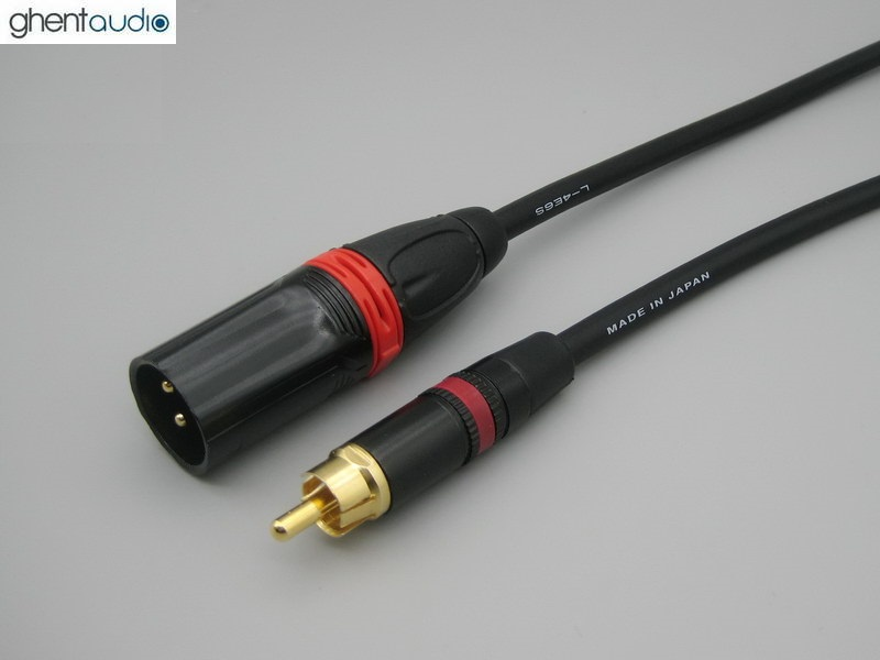

If you don't mind spending more you can get the following cables that may be of higher quality:

ghentaudio --- A15 Canare L-4E6S RCA to XLR Interconnect Audio Cable
Ghentaudio is a Chinese company but for some reason their cable was marked "made in Japan":D
Monoprice:
See page 17.

Thank you @PENG for being so detailed. I really appreciate it.
I'm thinking either the Monoprice or Benchmarks. The latter option should like it's higher quality but it's so easy to order the Monoprice through Amazon.
Which ones do you use?
PENG
I have the Monoprice Premier series that I used with my QSC RMX850a pro amp but I no longer has it so my RCA to XLR are idling. As I mentioned before, forum members asked how they would perform with the Denon AVRs I tested it last week and found no issues at all, virtually silent, though when I tested it with the amp powered on another outlet on a different feed, it did get noisier.
If you order from Amazon and if it doesn't work well you can return it and buy Benchmark's that costs more.
Pretty easy to make your own cables, too....what I did when I needed unbalanced to balanced....
