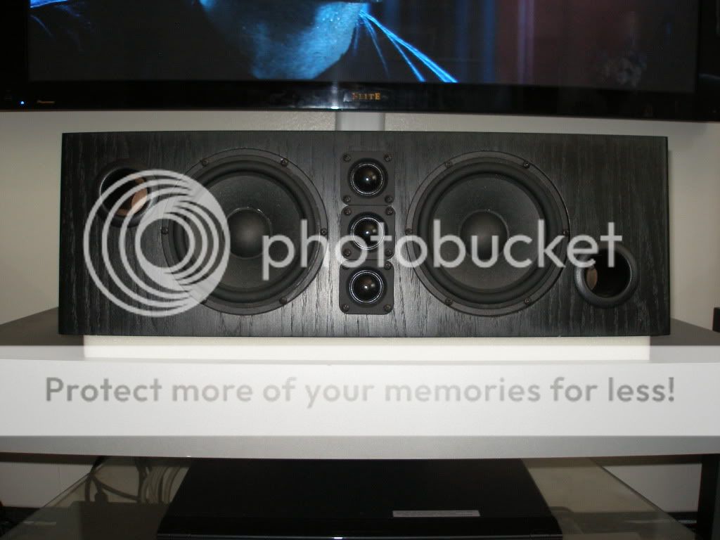

Sometimes I passive bi-amp my center http://www.sourcespeaker.com/CC-4.html which is rated at 220 watts with my Cinepro (350 watts 8 ohms- 500 watts 4 ohms) and I cook my system at around 115-120db and never a problem. I know this doesn't answer your question but I had to post this in anyway.
