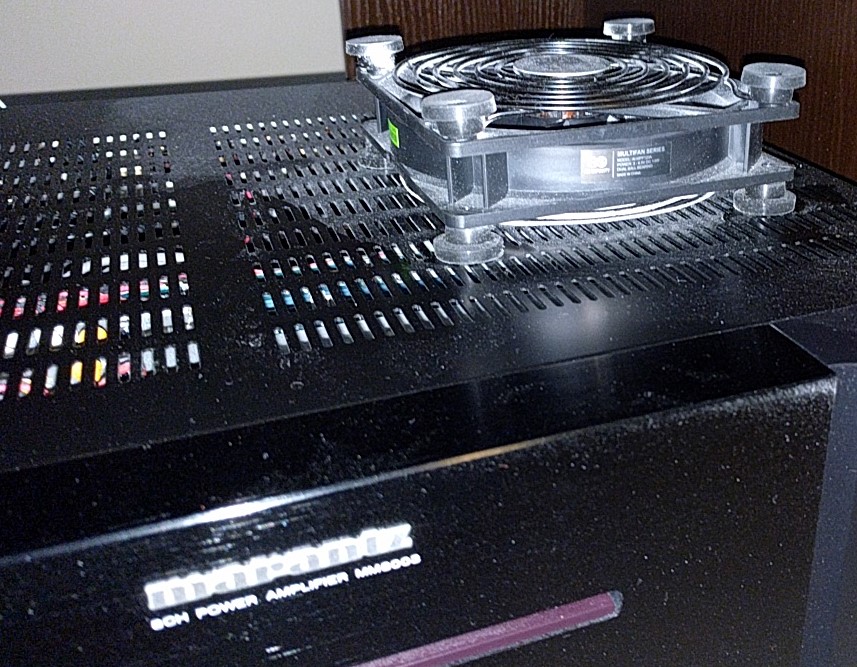

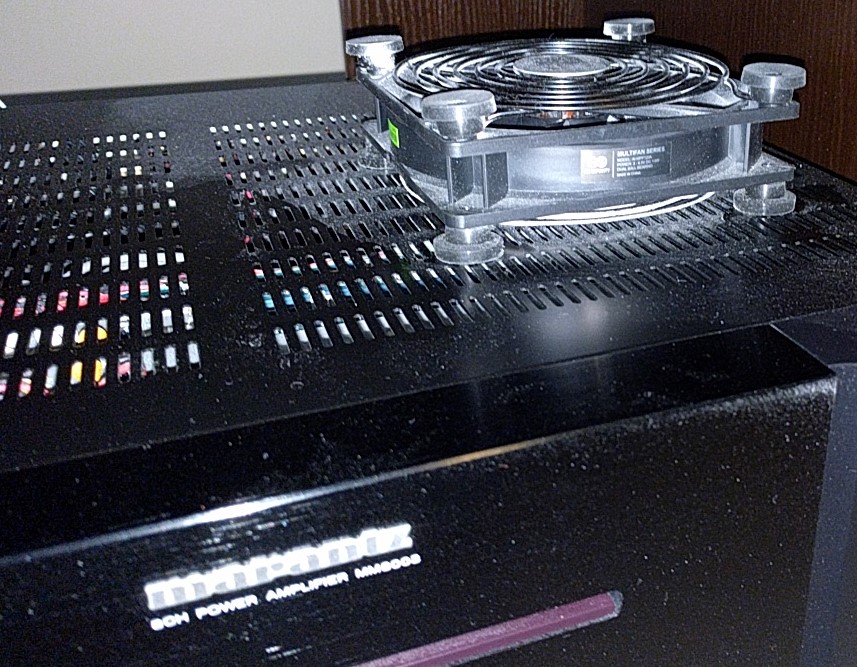

Phase 2 Audioholic Chief Dec 30, 2018 932 0 63 Aug 21, 2019 #41 PENG said: Anything? WhyView attachment 30666? Click to expand... Umm...Lol.. thanks PENG! For a few minutes last night I thought you was really mad at me. what's that on top? One of those little hovercrafts? . Can't be a drone, that'll be kinda like me. Just trying to be part of the collective like the Borg! I have been assimilated!
P PENG Audioholic Slumlord Oct 23, 2004 19,797 0 113 Ontario Aug 21, 2019 #42 Phase 2 said: Umm...Lol.. thanks PENG! For a few minutes last night I thought you was really mad at me. what that on top? One of those little hovercrafts? . Click to expand... Never mad at anyone on AH lol.. I didn't realize the thing needs a good vacuum already, just show how trouble free it has been. Reactions: Phase 2
