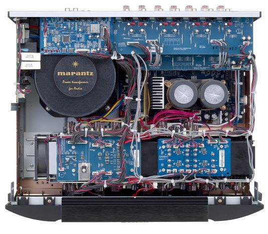

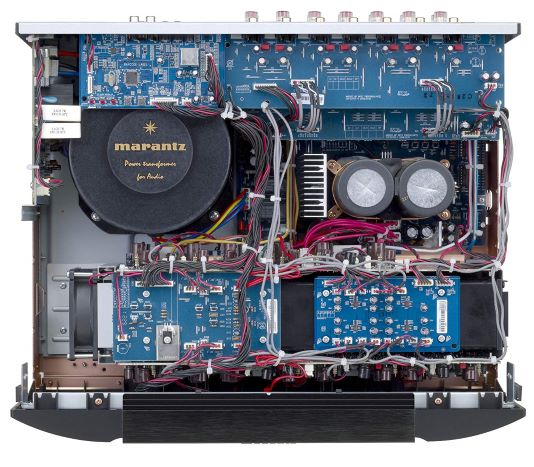

Like my MM8003, it is amazingly light weight but the power transformer's VA rating is higher than that of comparable emotiva amps relatively (to output) speaking. In fact it is comparable to that of the 200 WX5 big and heavy XPA-5. It has much more storage capacitance, 2X50,000 = 100,000 uf vs the XPA-5 gen 1's 60,000 uf.
The fans in my MM8003 never turns on, whether my external fan is on or not. They probably would turn on if I push the amp to near its limit with the external one off.
This amp (again, I assume it is the same as my MM8003 minus one channel) is silent, no hum no nothing, and the trigger works flawlessly.
Interestingly, based on S&V's measurements, my Denon AVR-4308CI actually has more output, but there aren't too many 140 W multichannel power amps that beat the AVR-4308 or 3808 anyway, strange, but true.

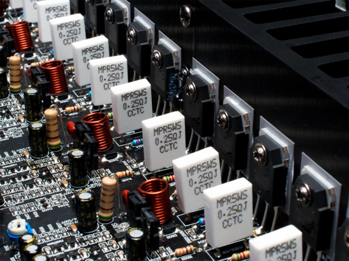

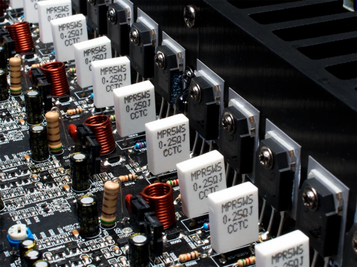

Umm, PENG I don't see them! Sorry but are they under the PC boards? They gotta be attached to the heat sinks.
In the first pic the power supply is somewhat obscured by wiring, but is behind the two large caps. Why would a power supply be connected to the heat sink vs the amp modules? You do see it in the second pic, right?
Ok, give me a minute or so, but I do understand what you're saying.
Like this rail..all those power trans mounted on the heatsink.
Phase 2
Phase 2
So you meant power transistors lol..
Ok I did ask, where are the power trans, at on the rail, I didn't say power supply.. in this case cause there are two in that amp design.

So I'll ask again, where did Marantz hide the dam power transistors? Inquiring minds want to know I don't see them gotta be under the boards? Huh? ..
Obviously they are hidden from view. You will have to disassemble the amp assemblies to see how they are mounted. The output transistor pairs are the Sanken 2SA1216 and 2SC2922 in case you want to know.

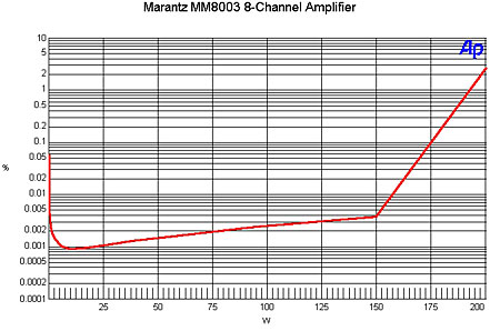

If you can find a used MM8003 for a good price, go for it. It measured better than the 8077 by Sound and vision. There is no reason though, as the two amps are almost identical internally.
https://www.soundandvision.com/content/marantz-av8003-preampprocessor-and-mm8003-multichannel-power-amplifier-measurements
https://www.soundandvision.com/content/marantz-av8801-surround-processor-amp-mm8077-amplifier-ht-labs-measures
Measurements for the 8003
image: https://www.soundandvision.com/images/archivesart/808mar.fig.jpg
This graph shows that the MM8003’s left amplifier channel, with two channels driving 8-ohm loads at 1kHz, reached 0.1% distortion at 174.8 watts and 1% distortion at 192.5 watts. Into 4 ohms, the amplifier reached 0.1% distortion at 248.0 watts and 1% distortion at 289.1 watts.
With five channels driven continuously into 8-ohm loads, the amp reached 0.1% distortion at 127.1 watts and 1% distortion at 150.1 watts.
With eight channels driven continuously into 8-ohm loads, the amp reached 0.1% distortion at 109.7 watts and 1% distortion at 122.3 watts. Under these conditions, the manufacturer’s stated distortion of 0.08 % was reached at 108.6 watts, which is considerably less than the 140Wpc specified by Marantz.
