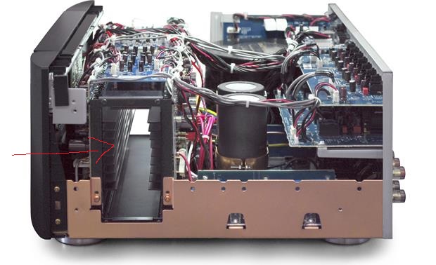

Umm...Lol.. thanks PENG! For a few minutes last night I thought you was really mad at me. ;) what's that on top? One of those little hovercrafts? ;):p. Can't be a drone, that'll be kinda like me. Just trying to be part of the collective like the Borg! I have been assimilated!:D
Umm...Lol.. thanks PENG! For a few minutes last night I thought you was really mad at me. ;) what that on top? One of those little hovercrafts? ;):p.
Never mad at anyone on AH lol.. I didn't realize the thing needs a good vacuum already, just show how trouble free it has been.

Like Denon, Yamaha, Sony, NAD, Anthem, Arcam and many other receiver manufacturers, they have been making all sorts of nice amps for years.
Yep, knew that just never seen a "tunnel" inside one. Good thing it wasn't a AVR, man TLS Guy, surely wouldn't like something like that in a amp..umm AVR. Just joking around man. I don't eat, live and breathe, transistors, diodes and resistors like you guys. But I do believe Hugo is the hulk in disguise. Gene said so once in a chat I had with him, in a inbox chat. ;)
Do not put anything on top of that amp! Just cause it has a fan inside still doesn't mean it will not overheat and shut down on you. You did say you like high volume listening. If you really decide to get one treat that nice Marantz amp like you would a fine woman, be gentle, kind to it, but when you do need to heat it up ;), remember cool down is very important with electronics. Just like a fine woman. Cuddle your amp afterwards so to speak.:p:D. have a good one down in Brazil! Oh you know of someone who can get me a really good deal on Colombian coffee beans? That dude Juan Valdez, his product isn't as good as it used to be. ;) I want some coffee beans straight off the bush straight to me.:p;):D. that's some humor in this post. Joking around some, and if you believe my sense of humor is strange, wait till you get to know some of the older members. ;):D
