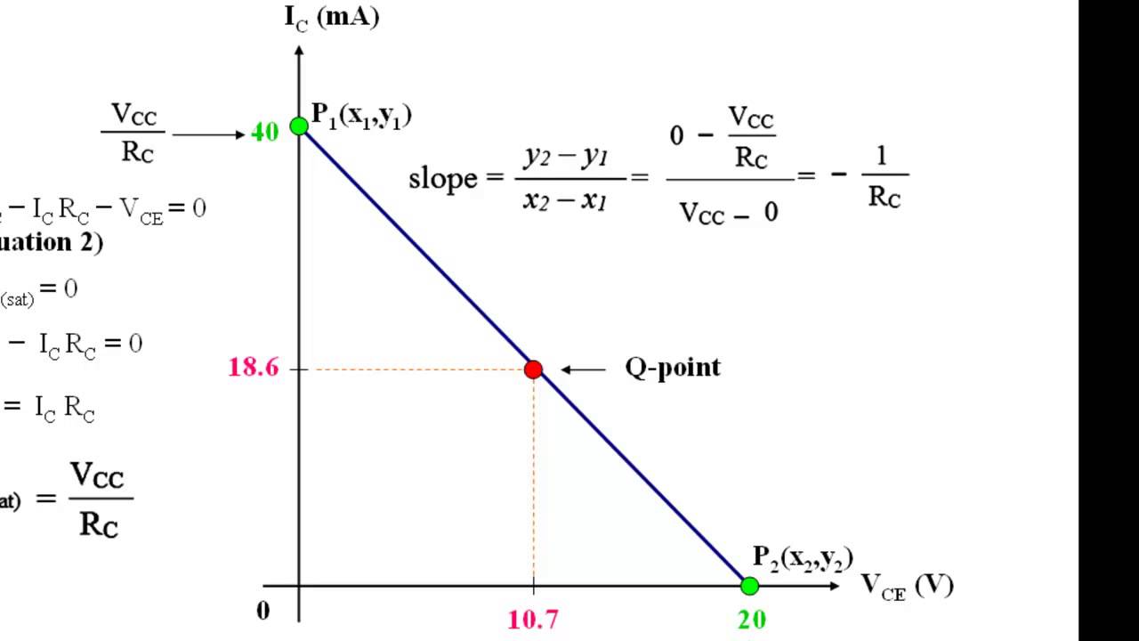

I suppose this observation must be explainable with the bias point (Quiescent Point) and the load line when biased to pure class A. Likely, @TLS Guy may enlighten us.
Now, we are getting technical, and may be over your head, but this diagram shows the gist of what I'm getting at here:

They're not pp types biased in class A, they're single ended. Output device (only one in the signal path) fully conducts even with no signal, producing lots of heat. With a signal, some of that goes into moving the speakers instead, thus less heat. It's also why psrr is so important, as supply hum will be amplified.
