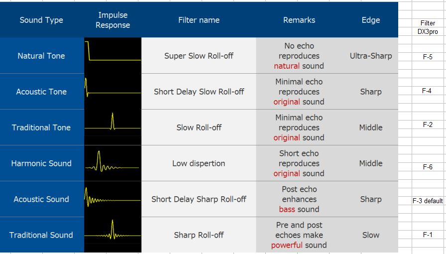

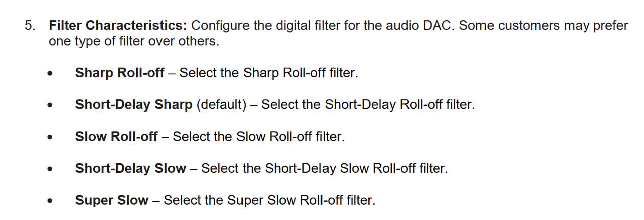

Also, I am wondering what the roll-off filters in the AKM4458VN DAC does in the UDP-203.
I understand this DAC is used in many AVR's too, especially in the AVR's I have been looking at, Denon, Marantz.
Does this affect the bass, midrange, treble?
What exactly is adjusted by these different filters?
