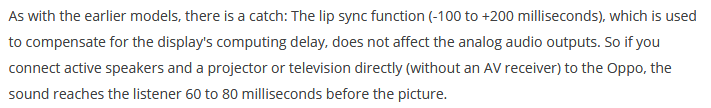

Oh, maybe this is a dealbreaker, found it on a German review site, see below:
Source: https://audiovision.de/oppo-udp-203-test/
I talked with OPPO support in Germany and they confirmed that the A/V Sync setting indeed affects the analogue multi-channel outputs, so this basically has me right back into the ballgame of using the UDP-203 as a preamplifier, paired with an Emotiva A-5175.
