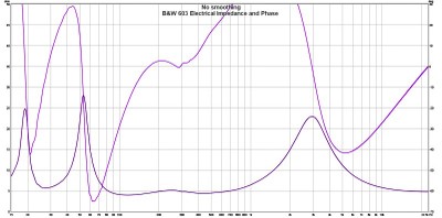

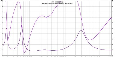

As Peng just noted the 702 S2 plot, note the similarities between the 802D2 and the 603S3
This is definitely part of their design philosophy as I've seen it since the introduction of the 800 Nautilus series.

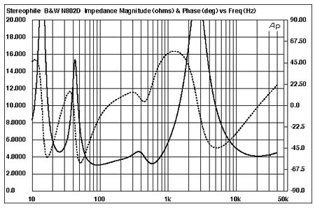

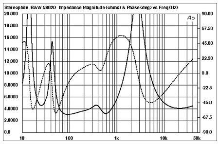

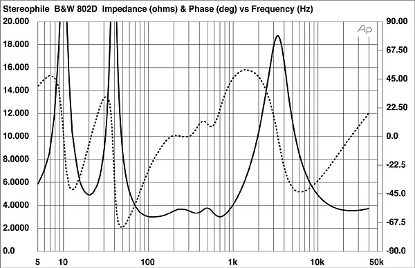

Here's what one of those monsters could potentially do to lesser power amps, and to themselves:
Just look at what JA noted:
The magnitude drops to 3 ohms between 100 and 130Hz, and again between 670 and 770Hz; and while the electrical phase angle is low in the lower region, it becomes increasingly inductive above 600Hz, reaching +46° at 1kHz, where the magnitude is 4 ohms. There is also a combination of 4 ohms and –64° at 69Hz, implying that this speaker does require an amplifier that is not upset by a low effective impedance.
The EPDR for those 800 diamonds must be below 3 or 2, even 1.5 ohms, though again it would be misleading to think that it would take as much current that a 2 ohm resistor load would, it really wouldn't, as the lower number simply tells you it would result in as much peak dissipation as the lower impedance number would.
I'd bet the EPDR is, would be, below 2 ohms.
