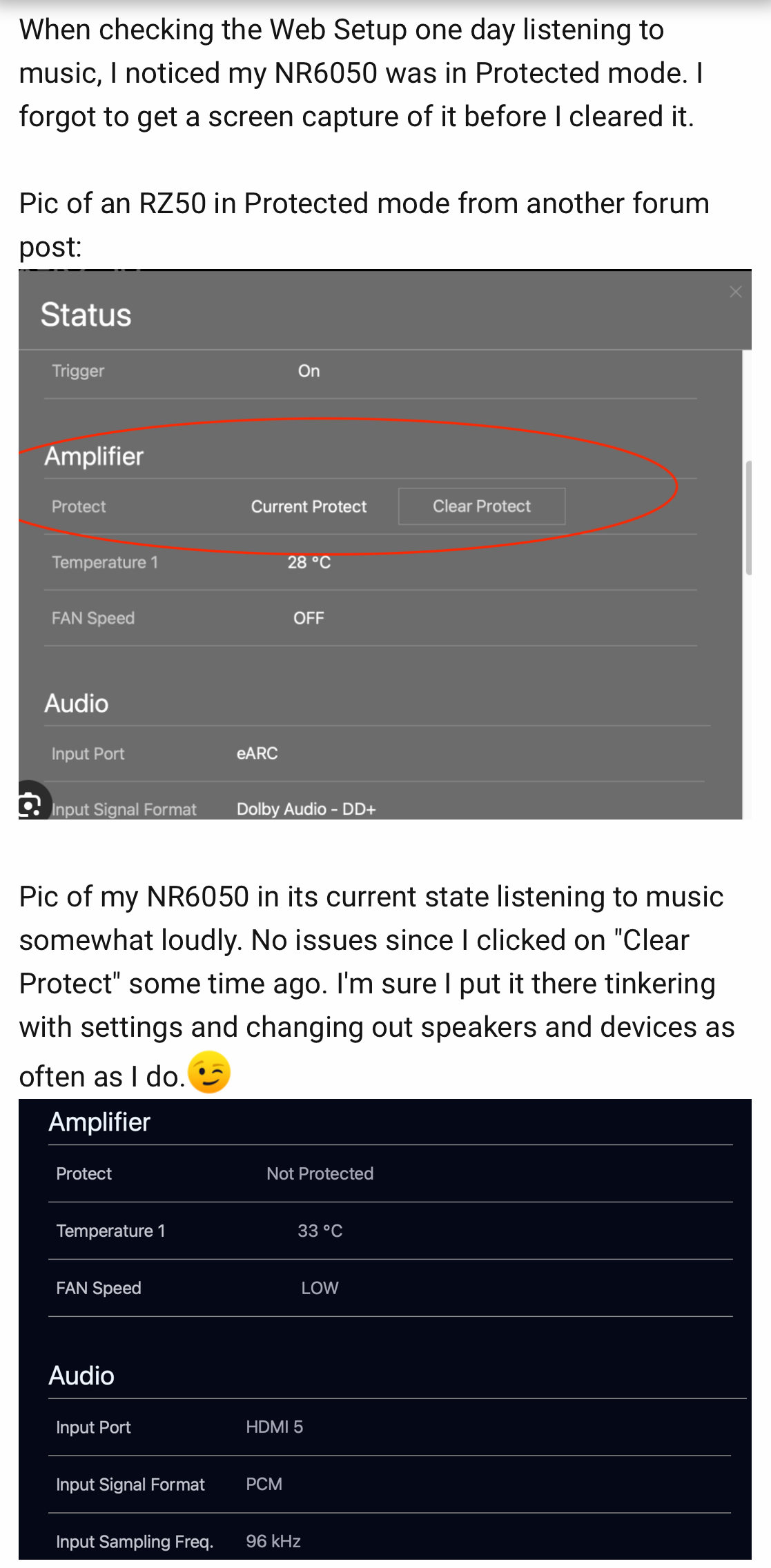

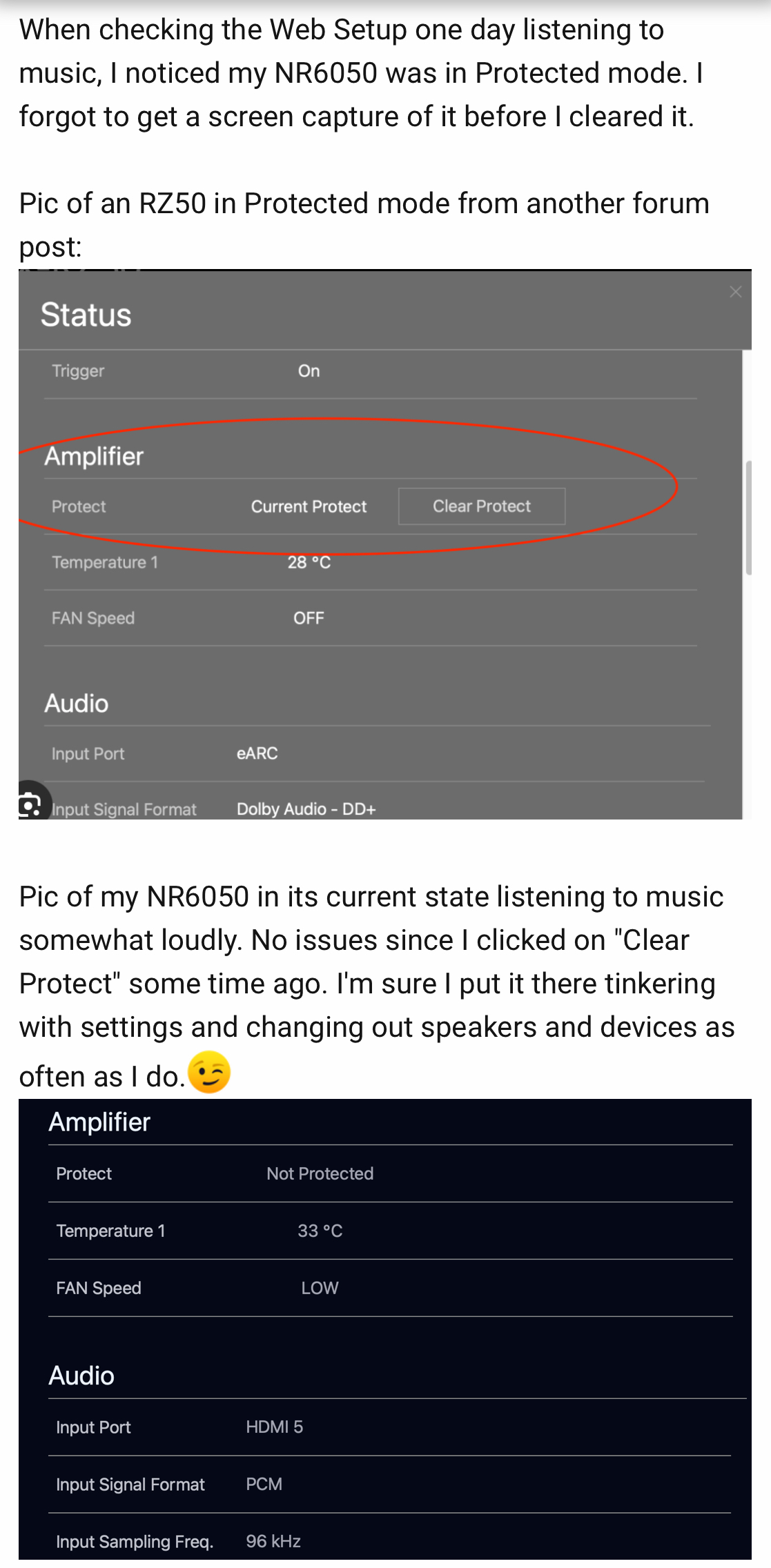

			So essentially in Denons switching to 4 ohm stops protection triggering too early, and allows thus producing more power for 4 ohm speakers.
Again, that could be possible in theory, but bench tests after bench tests show that it is not the case, so setting to 4 ohms will limit "power" severely, but if you don't need that much power then of course you will be fine, or more than fine, using the low setting.
If you are experiencing performance issues in your specific use case, then I would suggest you investigate further, as there could be other reasons.    To be clear, if the poorer performance you mentioned, such as weaker bass, was due to protection triggering too early, then you will know because Denon's protection scheme will trip the unit, not just limiting the current and continue to operate that way.    Some recent Onkyo models might (not 100% sure) in fact do what you described but certainly not Denon's X3700H.
