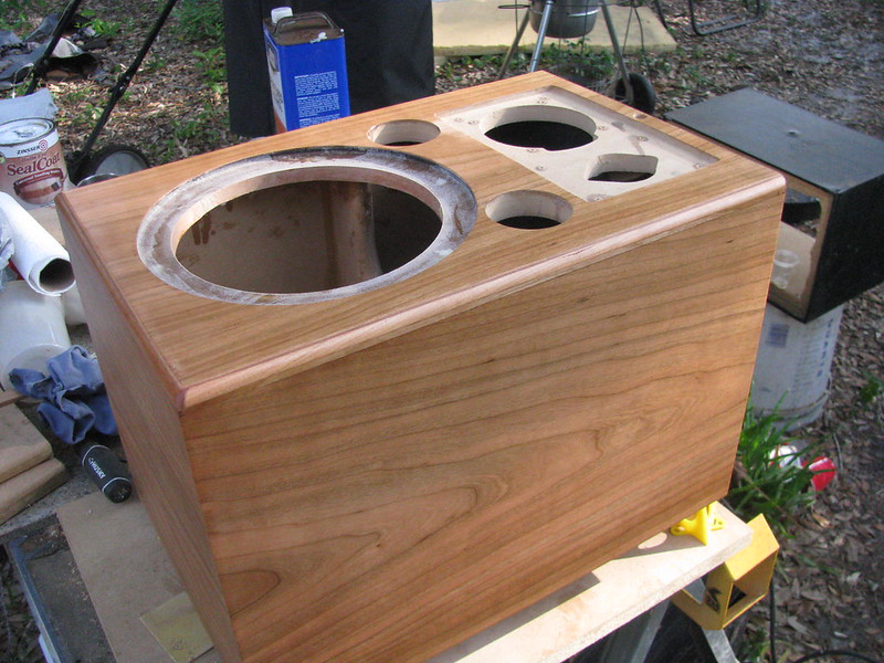

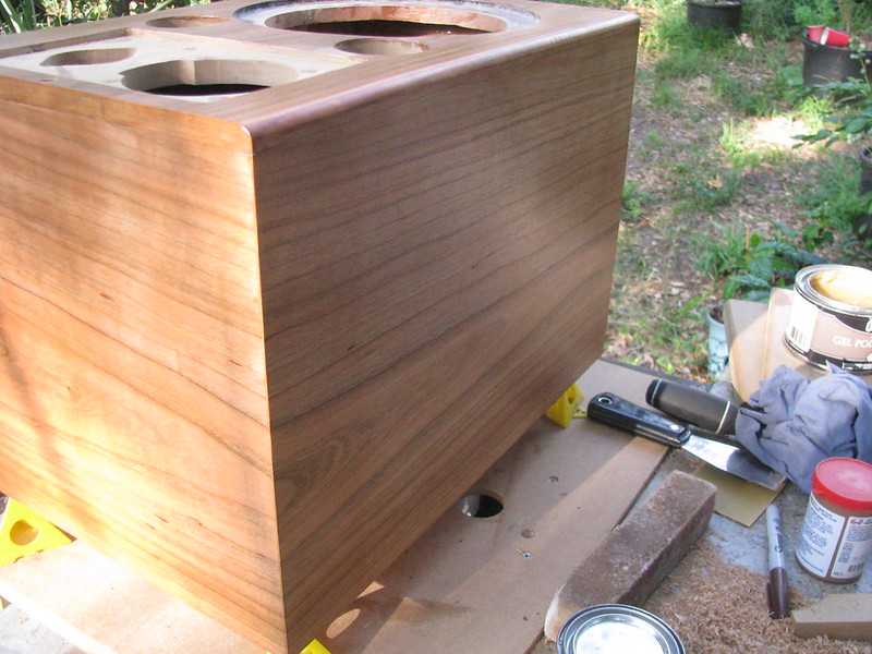

These are coming out nicely. I will let them age a bit and do some toner work to blend everything better. It's not bad now, but they could be improved further on down the road. Only the first coat of gel poly, over 2 coats of thinned shellac as a sanding sealer. There is some minor flaws but I mind them less now that the top coats are going on. It's 90 here today, but only 40% humidity so I went for it. I had to stain the edges of the wood backed veneer with a q-tip, where the backing (white, in contrast) was showing strong in the round-overs. Otherwise, the rest of it is finished natural.
