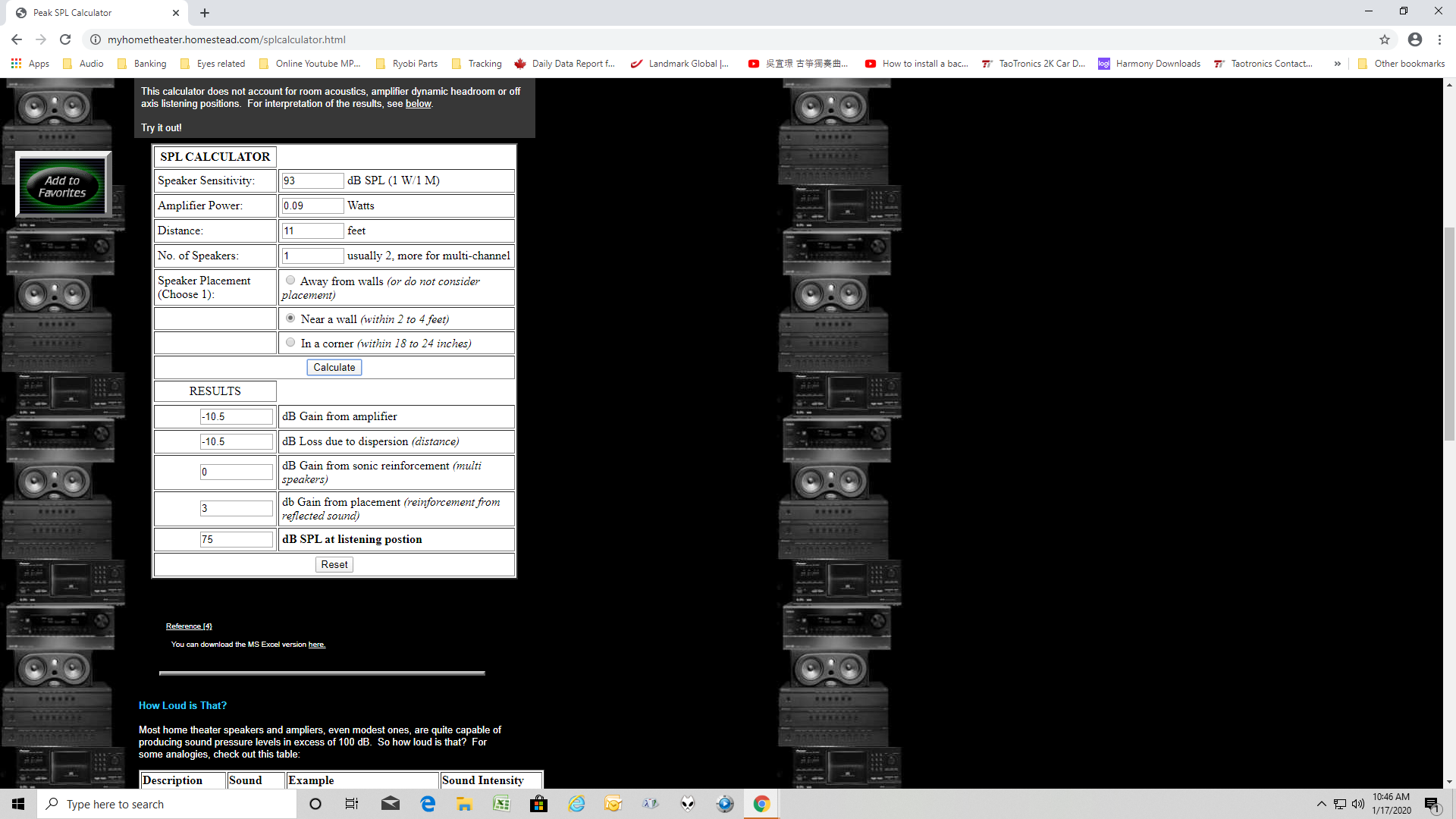

May be you sit far from the speakers in a large room and your "moderate" level is actually not moderate for others. The fact is, it depends, for example, I pasted the calculation for the OP's 91 dB 8 ohm speakers from 11 ft, he can get "moderate" level of 75 dB from just one speaker for 0.09 W, for your 4 ohm 87 dB speaker, it would be about 0.9 W so your 3XXX series Denon AVR should have no trouble providing all the punches you need two channel driven.
Now if you crank it up to reference level, like 85 dB average, then your AVR will have to output about 9 W average (if one speaker is used). That would still be fine without suffering from lack of dynamics for most music except certain tracks that have dynamic peaks of say >=12 dB and that's when you may perceive lack of "punches" and/or hear distortions. However, adding a 5X100W external amp is not going to offer "huge difference". Your claim must be taken with a grain of salt as others who take it as facts may be disappointed..

Normally, if you ran AARC properly, it would likely calibrate things so that when volume is at "0", you would be listening to "reference" level, or 85 dB average from you main mic position, and that would be about the same as what you would get sitting in a movie cinema, that is, very loud to the point extended exposure day after day to that level may result in hearing loss.
If Anthem use similar standards as the mainstay AVR manufacturers such as Denon, Yamaha, Marantz, Onkyo, Pioneer, with volume at -30 or even -10, there is no way your MRX would be pushing 75 W.
Even with just one single Monitor 11v7 should get you 85 dB average with 0.9 watt, or 105 dB peak with 90 W. That's just 1 speaker, based on your seating distance of 11 ft in your speaker's sensitivity at 93 dB/2.83V/1meter in room response.
If you listen at -10, and assuming 0 is reference, then you should be listening to about 75 dB average and that's just about my comfort level. In that case, your MRX would be cruising at around 0.01 WPC, that's no joke, it's science and reality!!

Yes you are correct, it doesn't make sense if I calibrate 0 to be reference level I should only be getting 85dB and not 100 something... this is odd, i need to go back and check my ARC measurement. Thank you for bring this out. I think my Anthem volume scale range from +10 to -80 something...
But you are correct, if it was calibrate properly, if I dial volume to 0dB i should get 85dB. And also from your SPL calculation, yes, 75W per channel from my Anthem receiver should be plenty...who needs a external amp!!!??:eek:
