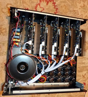

I don't know if the Rotel or Anthem is similar, but I do like the modular approach the Outlaw chose for their discrete amp boards:
