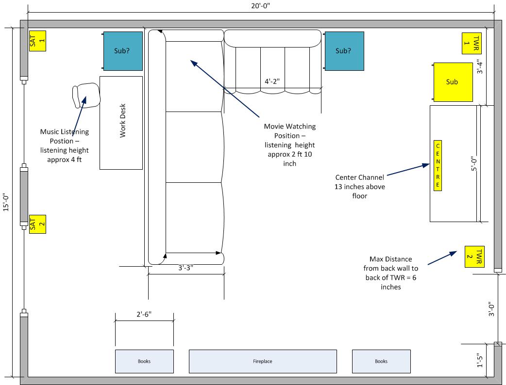

Hi Everyone,
Looking for some buying advice for an upgrade to my 5.1 setup. I've been doing a lot of reading and I have sort of narrowed it down to the list below. But before we begin:
I have attached a room layout for reference. It includes listening heights, and areas and the diagram is pretty much to scale.
Currently I have an Energy Take 5 Classic 5.1 system with a Denon AVR -X2200W Receiver in a 20 x 15 x 8 room. As you see in the diagram, because of room constraints, my surround speakers are placed in the back and not on the sides.
I use the system the following way:
70% of the time, its music. I have both stereo and multichannel music. Depending on how I like the sound, I may listen to stereo music in Surround (receiver does that). I listen to MCh music either in direct/pure direct or sometimes in Music Surround (usually a volume related choice). Music wise I have eclectic tastes, but most frequently we are looking at Rock/Heavy Metal. Mostly I listen at a conversation volume, but I'd like the option to blast once in a while. Also, I like my vocals/dialog to be clear and not overwhelmed by bass. But not harsh.

That's a nice diagram of your room. Thanks for sharing. That should help elicit more relevant advice I think.

A couple other questions come to mind - given that I don't have surrounds and am using just rears, would bi-pole surrounds be a better choice?
Subwoofer placements - any choice seem better? Again, I would do the crawl to make a final decision..
Also - forgot to add in the diagram - listening distance is around 13 ft at the couch..and more at the desk

70% music, right? Normally, I'd think monopole speakers would be better than bipole for music. But with your placement restrictions, a more diffuse sound from the rear might be preferable. Hard to predict.
For sub placement, again, hard to predict. You might add the lower right corner of the diagram to your list with a small footprint sub like an svs cylinder sub. Corner loading can help with sub bass extension. Near field positioning right behind the couch can take a bit more patience to integrate into your system to avoid directionality, but it can be done.

Thanks again Rojo. I don't think that corner is viable since its across a doorway. I'd have to run the cable across and there no pretty (read spouse-approved) way to do it. Also, thanks for that feedback. I have monopole energy takes right now and they sound pretty good. So, I wont make bipoles a higher priority than they need to be.
