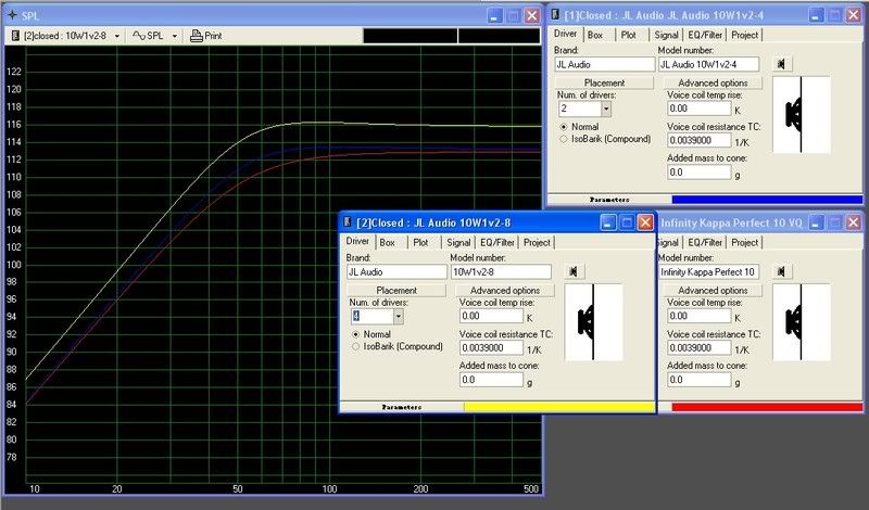

Why do you want to just play a 20 Hz frequency band? If someone wants to play 80 to 100 Hz! What does that mean? Or do you mean you want an F3 in that range. I have no idea what problem you are trying to solve.
yes, i want it to play exactly 80hz to 100hz.
(a 20hz band)
why?
cause i can?
(maybe i can't yet, but i want to and i will)
yes, i want to it play exactly 80hz to 100hz.
(a 20hz band)
why?
cause i can?
Well that makes no sense at all. There is no possible reason to do that, it could only possibly make a mess. You will have huge and uncontrollable band pass gain issues. The whole concept is just plain dippy, period.
As I have explained before, the wider the bandwidth between crossovers the better.
I strongly suspect you have mains with either no, or inadequate step response compensation, and you think this will compensate for it. It won't.
If you did want to do it, which I don't advise then this is your driver. Use two if them and you get an spl of 114db, in an enclosure volume is 0.8 cuft. Your best solution is to make a speakers with two of them as a two and a half way and crossover to your subs at 80 Hz. I have a complete design for this. The driver is a good substitute for the Dynaudio drivers in my NFM-1 monitors. The crossover is first order low pass and second order high pass, with a choice of two crossover frequencies on the fill driver, depending on room gain. It makes an extremely accurate and pleasant speaker.
Those speakers as mains would be light years ahead of what you are using now.
