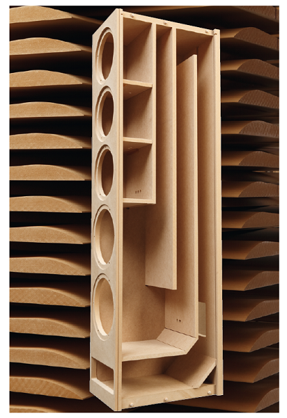

Come on... you know you want this...
I was surfing yesterday and found a reddit thread in which a guy took in-room measurements of his TCD-110S for troubleshooting purposes. That's some mean bass for a tower that's only 130 pounds. T&A's advertised 22Hz wasn't wishful thinking. :eek:

Maybe it's coaxial.
It's a recessed dome in a constant directivity housing. The off axis dispersion is great, but actually too good for my small room and I have them toed out about 10 degrees. Way too much presence otherwise; not bad sound, but it just wasn't right. Our next house won't come soon enough, let me tell you. F these small rooms.

Nice, @Kvn_Walker . Nice. Based on everything I read so far, the line geometry seems a little weird... too narrow of a cross section perhaps, but maybe the length makes up for it(?). I’m guessing this may fit into the mass-loaded category a bit. Regardless, the proof is s in the pudding, and their lab test is pretty tight.
