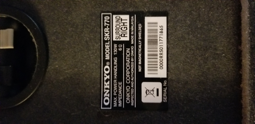

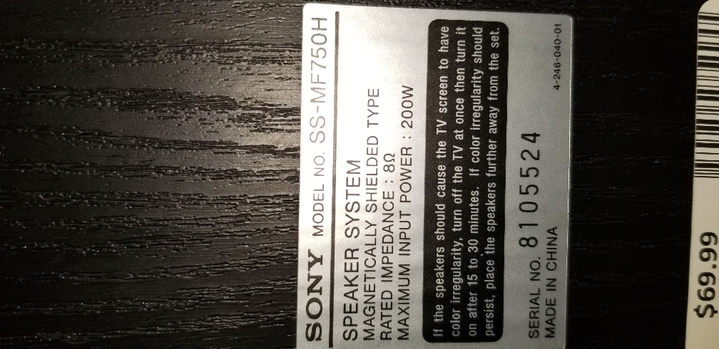

Sony's I have as my front left and right. Onkyo center, surround l/r, and rear l/r

Speaker power ratings dont really say anything but sensitivity does as does the ohm rating(if honest). If you get 4ohm speakers they will be a bit harder to drive for the amp so something to keep in mind. A low sensitivity rating will also require more power for a set volume at the listening position. 86dB is low but 88dB is fine, nothing wrong with lower but might need more power.
Speakers are so difficult to recommend because they are somewhat different and everyone have different tastes. A huge simplification is more expensive is better but thats not always true, though for the most part a 500$ speaker is usually quite a step up from a 200$ one. Listening in stores is always difficult because its noisy, they play loud, often short and it isnt the same as your room but its a good idea to go to a decent store and listen to a few different price range speakers and a few different brands. Make sure they dont play it too loud and using a phone dB app so they are somewhat same volume can be a good idea.
Get the same brand center speaker, same line or if movies/tv is what you use it for by a large margin a step up might also work very well if similar. The center is the most important for tv/movies.
