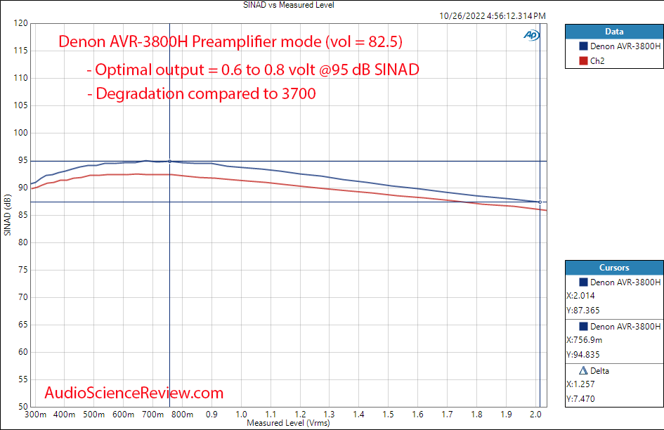

I had contacted Parasound and the rep said just to make sure there was enough voltage out of the pre outs to ensure a high enough volume. He said.
SINAD (signal to noise and distortion) doesn't matter much matching components. It sounds like the new Denon has a little bit worse SINAD specs. Those specs are still so low that it is doubtful you could actually hear a difference. Both Parasound amps will be a great match and offer a significant improvement over the Denon's onboard amps.
The most important spec would be the voltage output from the Denon preamp outputs. I would want to see at least 1V, above 2V would be better, otherwise you may not get enough volume level.
I have already explained why you can't just say 1 V, or 2 V is required or enough, it depends on many factors. If the rep was making a general statement then he should have said at least 2 V, then it will at least covers all of the power amps they sell. Denon's rep is simply reading what the manual says about the 1.2 V. They generally don't have much technical knowledge, though if you insist, and if they let you communicate with their "engineers"/2nd line technical support staff, then it is okay. Some or most of those people (second line or above..) should be knowledgeable enough to ask technical questions.

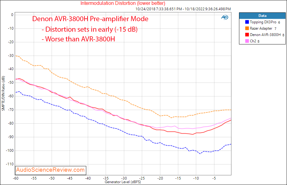

I am not sure what your point really is about "..can't drive any power amp to max output..". "Any"? It certainly can drive many commonly used power amps such as the 200 W Monolith's and many other amps! Regardless, he has no way of knowing what kind of power amps people will use with their AVR, but he provided the graph of SINAD vs output level for up to 2 V, that's pretty typical for most reviewers including Gene who also mentioned that 2 V is what one should aim for, higher is better obviously but 2 V can drive class AB amps that typically have gains around 28 to 30 dB gain to 315 (28 dB gain) to 500 W (30 dB gain) 8 ohms.
If you want to see the SINAD (harmonic distortions and noise) or IMD (intermodulation distortions) in the lower output range, all you have to do is to read the graphs included in his measurements, such as the following:
I think you're agreeing with me. I was replying to someone implying the X3800H might not be able to drive lower gain amps. They were misinterpreting the measurements showing max SINAD at a lower voltage as meaning the pre-amp was incapable of higher voltages. Like you, I was pointing out that Amir's voltage sweep did not identify an upper limit to the pre-amp output as we are still ~87dB SINAD at the highest measured voltage.
PENG
Right! Please also remind him that pre out voltage will vary continuously with the music signal. For example, in my HT room, my Denon's pre out would be at below 0.3 V most of the time. You must have read that for a lot of home users, their amps would be cruising at only a few watts most of the time.
That's why even for AVRs such as the Anthem MRX520 and NAD T758V3 AVRs ASR measured with 50 to 60 dB SINAD, their owners could still love their sound quality, that could simply be that within the range of their preamp and power amp output range, SINADs were much higher, and would stay well below the threshold for them.
If he is not limited by his budget then obviously it is good to go with the highest pre out voltage at the highest possible SINAD, and same for power amps, go for the highest number one is willing to spend. Then one would not have to worry about anything, but..:)
