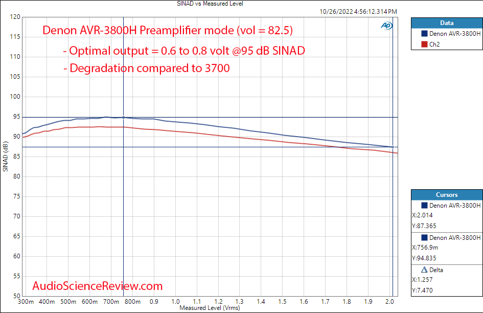

The A23+ and 2125v2 input sensitivity specs are clearly stated. My point was that some people seemed to think the 1 V, 28.28V, 8 ohms mean they only need 1 V pre out voltage from their AVR or AVP, and that is not the case.
1 V, for 28.28V at 8 ohms mean if you connect it to a pre out (preamp output) voltage of 1 V, you will get 28.28 V out of the power amp.
The power formula for a resistor load is P = VI, or P = I² X R, or = V² / R
so for 28.28 V, 8 ohm, Power output = 28.28X28.28/8 = about 100 W.
Using the A23+ as an example, the amp is rated 160 W into 8 ohms, that means an input of 1 V will not drive it to output 160 W, but only 100 W.
To reach the A23+ full rated 160 W output, you will need about 1.3 V. (see the spreadsheet table I attached in my earlier post on page 11)

The X4800H should perform about the same as the X3800H because it has the same preamp vol and dac ICs and the X3700H and X4700H did perform the same based on ASR's previous bench tests.
Those AVR's preamp/dac can output well above 3 V so any of them can drive your Parasound power amps to their rated output without any issues.
About your SINAD question, my suggestion is that people should not focus on just one single point, such as SINAD (or THD+N) at 2 V. That would be like saying your speaker's impedance is 8 ohm, when in fact such values are not one single fixed or constant value. They tend to always vary with another parameter.
So if you can find the curve, that's what you should focus on.
I posted the ASR provided curve before, here it is for you again:
If you have question about the curve, just ask..

PENG
The SINAD is the signal to noise and distortion ratio. In this case, it defines the quality of the signal through the digital to analog conversion process. This alone does not signify the quality of the audio from the output of the AVR in totally. There are other components that are tuned to optimize what you hear from the unit. When the DACs were switched from AKM to TI, our Engineering team fine tuned these other components to ensure that the AVR's output is at an optimum quality.
They are correct, obviously but even if they tuned all the other components to the best they can, it is not possible to improve SINAD higher than what the DAC IC can deliver.
Take a look again of what was posted before:
You can see that in the signal path (yellow), once the signal flow through the DAC, there is nothing else in the path that can bring SINAD back up from 93 dB, that is the spec of the DAC chip itself!!
It is possible to improve on noise for 3 to 6 dB if the DAC is implemented in differential mode but that is not the case here. The only Denon, including Marantz AVP/AVR that has ever use twice as many DAC ICs full differential implementation was the AVP-A1HD that Gene reviewed years ago.

First of all, you are welcome! As always, happy to help if I could.
I am not sure what you meant by "and my front stage is rated at 98dB with the center being 97dB. "
Did you mean spl from your main listening position based on an online calculator?
Reference level is 85 dB with 20 dB peak so total of 105 dB for the highest peaks in movies that follow THX standards.
If you need less than 1 V, then yes the X3800H can give you pre out SINAD of 90 dB, may be a little less at the lowest output levels. Keep in mind of the following consideration (not limited to) though:
- The graph Amir provided, same as similar graphs Gene included in many of his reviews/measurements typically specified the test signals that in many cases could be 1 kHz sine wave.
So at higher test frequencies, SINAD could be lower.
- The around 90 dB SINAD is for the pre outs, when measured at the power amp's binding posts, it would be around mid 80's such as 85 to 87 dB.
In order to see a better overall picture, you should read all the graphs if you are comparing the measured performance of A vs B.

Well then you should focus on the 0 to 1 V performance part of the curves for sure. Also, for your requirements, you can do better spending the money or other thing that matters more than using external amps.
