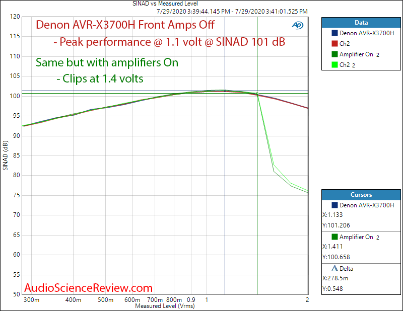

The X3700 measured 1.4v when power amps were in use, and close to 4V when they weren't (from memory)
Not really true, at least not entirely true! That 1.4 V reference, assuming you got it from ASR, is just one point on Amir's SINAD (dB) vs Measured load (Vrms) graphs derived from the AP instrument.
Let's be clear that the 1.4V is not the maximum output even when the internet amps are used. I have repeated this point a many times. Unfortunately if Amir (ASR) says something, people would (understandably) repeat it, sometimes taken out of context, and that led to misconceptions on forums.
As experienced Audioholics, I think we should not contribute to spreading the 1.4 V presumed/false limit when it clearly is not. Amir never said it was the limit either, but he was awfully harsh in using the term "clips" on those graphs.
In general, people should not look at output at a single point on the output vs SINAD, or THD+N graphs, the same applies to both preamp and power amps.
Now let's look at the graphs, that unfortunately I also posted several times to help debunk the notion of the 1.4 V perceived limit:
Observations:
1) SINAD was about 100 dB (0.001% THD+N)
2) At 1.4 V, 77.5 dB (about 0.013% THD+N) at about 1.7 V
3) 2V it was about 76 dB or 0.016%.(about and 76)
4) If you extend the line to 4V, assuming the same slope, it would be about 65 dB, or 0.056%.
Note: 76 dB SINAD, the AVR-X3700H would be almost 1 full dB better than the AV7705 (two samples measured by Amir), and we all know the AV7705 is a so called separate, without any influence of the internal power amps that are not even there!! Also, there are many very happy owners of the AV7705 that they thought it sounded great to them so I highly doubt 75 to 77 dB SINAD at 2 V is an issue for most (there are always exceptions obviously) people.
Observations:

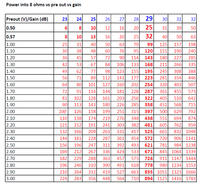

Thanks, I just need 2.7Vrms for my power amplifier. I'm currently looking at getting a Denon 6500 or 6700, not sure if it's worth the ~$1,100 price difference to get a 6700, especially if the 6500 pre-out voltage and distortion figures are fine.
In my opinion, a lot of people don't even need more than 1 V. I rarely listen to music or movie at higher than -15 so my AVR, or AVP will only need to output about 0.1 to 1 V (just an average range), with peaks to 1 V or a little higher.
For reference, by now we all know if you only need 1.4 - 1.5 V pre out voltage, you can expect SINAD would be between 96 to 102 dB, that's around 0.001% THD+N. I understood you said you need 2.7 Vrms for you power amplifier, but how did you come up with that number. If 2.7 V is the so called input sensitivity of the power amp then it does NOT mean you actually need 2.7 V. What if your power amp is rated 1,000 W or higher, do you actully need to push the amp to output 1,000 W or higher?
Obviously ymmv because it depends on you speaker's impedance, sensitivity, how loud you listen to, your seating distance, the gain and rated output of your power amp.
Again, just because you need 2.7 V for your power amp to output its rated power, it does not mean you actually need 2.7 V.
For example, let's assume your power amp has the following specs:
Gain: 26 dB
Rated output 350 w 8 ohms
In this case, 2.7 V pre out will drive this amp to output about 360 W 8 ohms, or 720 W 4 ohms.
Now if for your speakers, distance, and listening habits you only need 0.5 W average, 32 W peak based on 8 ohm impedance, then you will need just 0.8 V pre out voltage and even lower, such as 0.566 V if you amp's gain is the more typical 29 dB instead of the relatively low 26 dB.
So take a look of the following table and find your answer.
Red: Power in W
Blue: Power amp gain in dB
Black: Pre out voltage in Vrms required for the targeted output power into 8 ohms
Note: Double the output power figure for 4 ohm loads.

In my opinion, a lot of people don't even need more than 1 V. I rarely listen to music or movie at higher than -15 so my AVR, or AVP will only need to output about 0.1 to 1 V, less than 0.05 V, with peaks to 1 V at the most.
Gain: 26 dB
Red: Power in W
Great guess! Gain for my amp is said to be 26.4dB. The amp's specs say input sensitivity is 2.71 Vrms. The amp has only XLR inputs on it, no rca's. So, I have to use adapters on the rca cables that connect my pre-amp to the power amp. The pre-amp has home theater bypass.
Observations:

Thank you - yes I was being lazy... I was referring to Amir's review on ASR, by memory.
The 1.4V being the point at which performance takes a dramatic turn for the worse... Looking at those charts, I would be hesitant to depend on anything beyong 1.4V - as there may be other issues there (based on the dramatic downturn)...
We have had this conversation before but I think some people (base on many posts I have seen here and on ASR) are misguided by those graph. Take a carefully look and you will see that the scale of the graph's axis is playing trick too.
For example, if the Y-axis starts from 0 dB, the slope would have been much gentler, and if the X-axis starts from 0 V, the slope would be gentler still.
Now take a look of the very well reviewed AVM70, users seem to be very happy and said it sounded great.
See that at below 1 W (green curve, with vol=0, and the blue curve with vol=-4.5, SINAD dropped from 100 dB (the optimal point) to 88 dB at 0.6 V where the AVR-X3700H would still be at about 92.5 dB. That has little to do with the topic we have been on, but just a by the way kind of point. We both know many posters have in the past emphasized the importance of good performance at the lower output level, such as below 0.5 V for preamps and below 1 W for power amps, because that's the level amps operate for most users who cannot stand reference level. I don't fully agree with that sentiment, but I agree it is an important point to consider.
For someone like me who doesn't need to push pass 0.5 V very often, the much cheaper X3700H AVR will in fact have a cleaner preamp signal than the very well regarded Anthem AVM70! That's one of the point I tried to make that, it is much more useful, even critical in some cases, to compare the well scaled SINAD vs output voltage, than a SINAD vs a single point output voltage.
In any case - I have yet to encounter a power amp in my personal experience (ie: in my ownership, or in my hands to try out) - that wouldn't provide its max output at 1.4V or below - so I don't consider it a major issue... just a point of interest, and an indication as to how that component is set up.
Exactly, and same here as stated above. I am glad we agree on this one:). The high pre out voltage thing, while important for people to realize, could sometimes make people worry for no reasons too.
Regardless, I do appreciate Gene who highlighted the importance to have 2 V clean signal on hand, but those who own speakers with sensitivity in the high 80's to 90s, sitting less than 3 meters from their farthest speakers and/or listen to 6 dB or more below reference level probably don't need more than 1 V if their power amps have gains of 29 dB or higher and iirc, Gene mentioned that too more than once.
There are others who have speakers with sensitivity in the low to mid 80's, power amp with gains below 28 dB to say 23 dB to 26 dB such as the AHB2 and the likes of some class D amps such as the Hypex and Purifi based amps. Those people would likely need to have pre out voltage higher than 1.2 V, such as 2 V or higher and still maintain SINAD of better than 70 dB, but that still would depend on their seating distance and listening habit.
