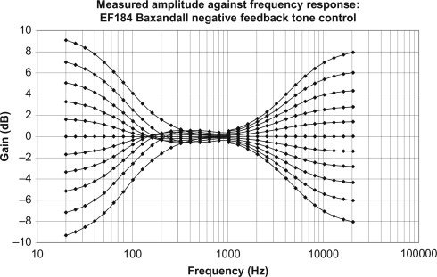

No, you asked an important question. This has provided one of the best teaching moments we have had in a long while.
You obviously have a good ear and knew things we not optimal. You had been misled that you can correct this problem by changing amps.
So let's continue, so you can see what you did.
The controls you have will be based very closely on the tone control circuit developed by the British Engineer Peter Baxandall in 1952.
Here is a representation of the frequency adjustments your tone controls make.
If you look closely, you will see why you are happier with your rig. From your description of what you did, it will follow the first line to the right below the x-axis.
That makes it obvious why it helped correct the frequency response error I had previously measured. Now you will see it is not perfect, as it starts to reduce treble energy a little too soon, and continues it past the point where is is required. This is where a parametric equalizer would be a better solution, but I don't believe that amp has a tape monitor loop that would allow you to use one.
