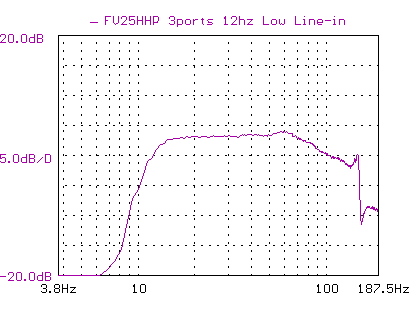

Where did you get that graph for starters? Rythmik's F15HP starts to roll off at 70 but not the F18, or the F25 according to DBASE. Just because one rolls of doesnt mean all Rythmiks sub do. Rythmik amps do have selectable slopes but the way you worded that in the SVS comparison came across as Rythmik not having that option. Present all the facts or dont present any at all because selective or omission of facts comes across as nothing but personal bias.

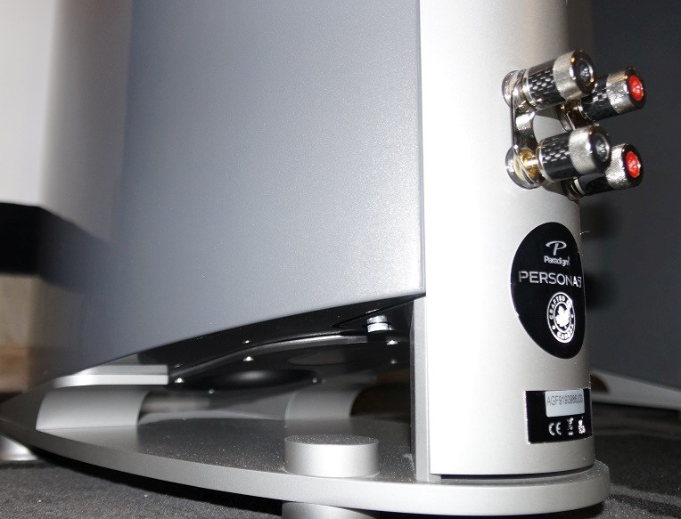

Thanks for all the good info. The canton’s will be hard to plug as I would have to remove the baseplate to get to it. All my other speakers would be easy. And they come with plugs. The cantons don’t.
You can still do all of that without plugging the port, but the problem is that the Cantons will probably have pretty deep extension, maybe down to 30 Hz. If you only had the subs play where the Canton's are rolling off, you would hardly get half an octave of use out of them. If you decide to use the subs to higher frequencies, then they will be outputting bass along with the Cantons, which is going to add up to a lot of bass if you run the Hsu subs at more the quiet levels.
However, I am looking at a product page for the speakers you have (these are them, right?), and it doesn't look like the baseplate would be blocking the port? Normally, tower speakers that have down-firing ports have this kind of arrangement:
But there is no spacing between the baseplate and cabinet that I can see in your Canton speakers. In fact, the bottom of the Canton speakers look like they would be so low to the ground that they would inhibit the functionality of any down-firing ports. Do you know if there is a picture of the bottom of that speaker that I could look at anywhere?

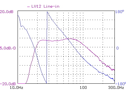

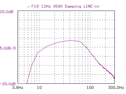

You are right that not all the Rythmik subs have low upper frequency roll-off points, but most of them do- so long as you are using inputs other then the LFE in. ematthews is using a speaker level input, not the LFE in. Look at the response graphs for the models you mentioned when not using the LFE input:
F18:
LV12R:
F25HP:
The F25HP isn't that bad at the high end, but we still see the upper end roll-off at 70 Hz. It probably wouldn't be very audible though, however the F18 could be a problem. The fundamental performance of the Rythmik subs are good, but they are not subs I would recommend if you are not going to use the LFE input and may be crossing them over higher than 80 Hz.

I was wrong. The base plate is part of the port.
It shouldn't be very difficult to plug then? If you have polyurethane foam lying around, an easy port plug to make would be to just cut out a circular part that is the diameter of the port, so long as it is a couple inches thick. You could even used a rolled-up towel, so long as you have a snug fit and it occupies enough of the port length.
